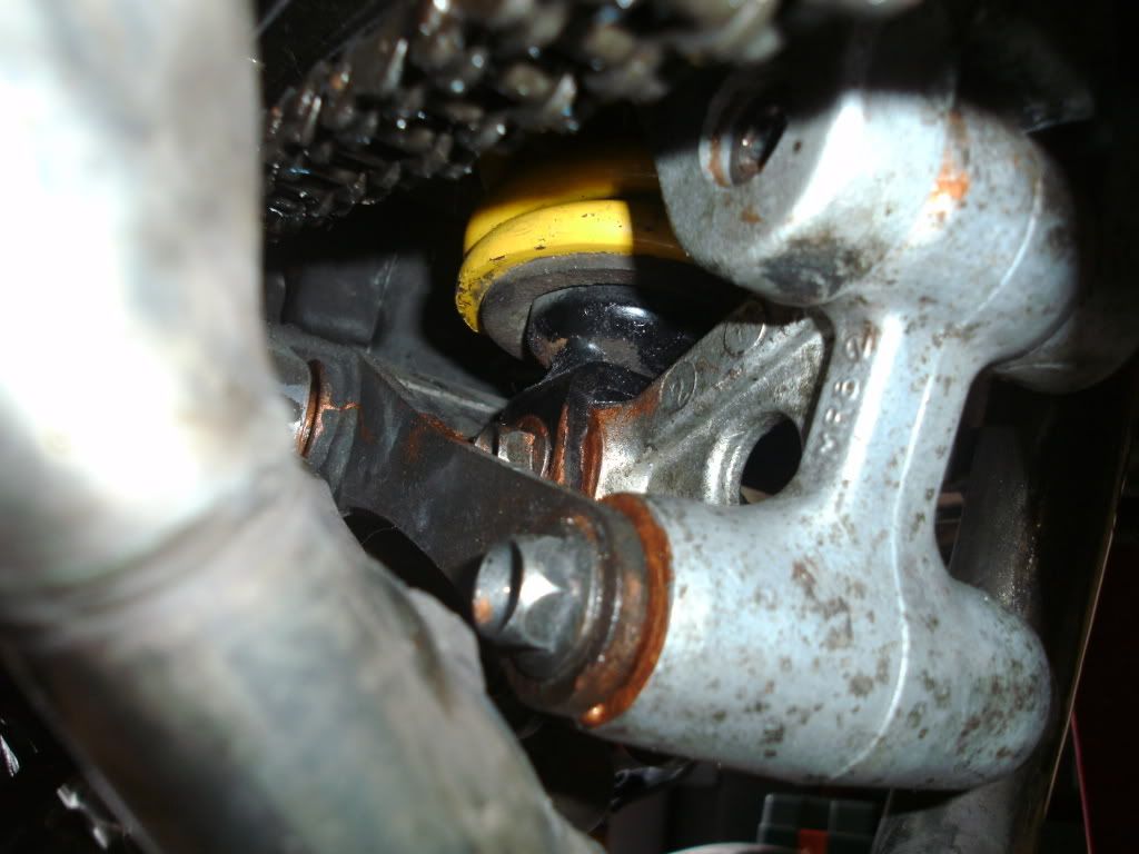

heres the sv one anyway:
this is the best ( when i best it is the only one i can find at this angle ) 'distance' shot of the shock fitted,

Re: Quick question
good stuff there..yeh the Tyga tail has the metal battery box and contoured undertray but very similar to your 600rr undertray. i'm going for an RS250 shock as it has the remote reservoir which i can mount in a few spots i think. but yeh similarly i haven't come across any Tyga kitted bikes with the 600rr or gsxr rear shock so that may be an all to obvious sign
