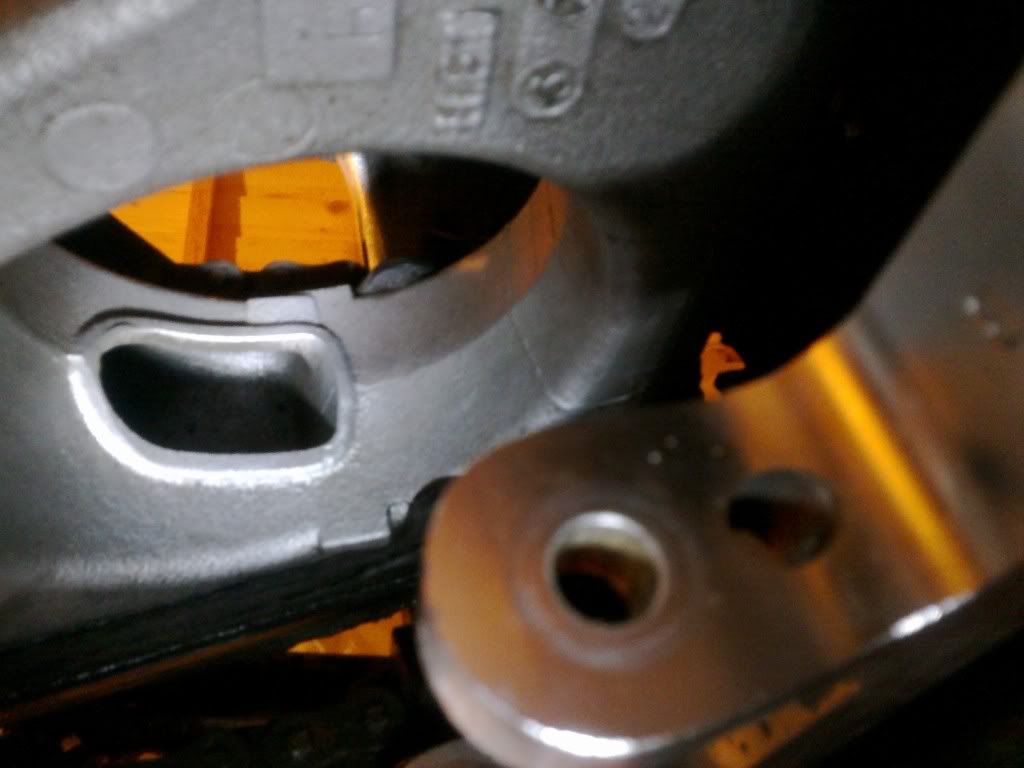

Need to swap out Rear shock.

Re: Need to swap out Rear shock.
Got sorted Lads thanks- Jacked up the rear with the paddock stand, put step ladders either side of indicators, placed barbell under the subframe and removed paddock stand letting the barbell take the weight of the bike. Took rear wheel off and jacked up the swingarm with a trolley jack, the bolts holding the shock in came out by hand happy days!
