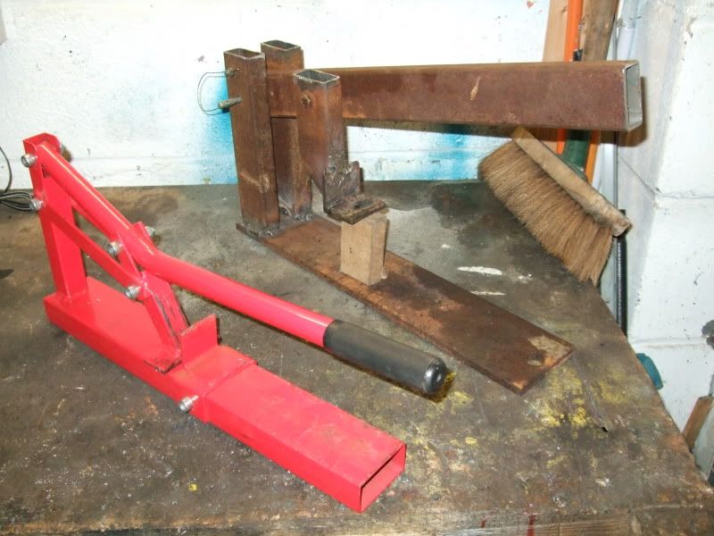

Easy enough, about an hour to cut it out and half an hour to weld it and drill a couple of holes.

Fuck me. That is industrial!
You should stick a side by side with the red one and yours..
Impressive work though..saves you £50 for a bead breaker eh?

There you go. I don't do delicate, and I can't weld anything thinner than 3mm steel, I just blow holes through it.
Pleased with the result.
A comparison between yours Mark and mine.
