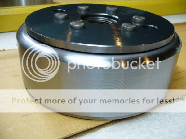

CMSMJ1 , I know i-factory in Japan did a lighter version of the standard fly-wheel they also do an exchange service. It also seems that they machined the outside of the fly-wheel rather than the inside
they claim :RVF400 lightweight flywheel.
Price: Yen 29.400
(And processing only OK)
Extend the life of the crank, improved pickup
Suppose that's for the lightening only
IMO G-force is definitely the way to go
How much did you fork out all in for the G-force kit, parts etc ? I was a bit late to snatch one unfortunately
think I should
and see If they would make some more.
Webpage: http://www.i-factory.ne.jp/parts/parts06.html" onclick="window.open(this.href);return false;

- Posts: 7166
Re: Removing the fly-wheel
@ G-man - I have the Gsxr1000 flywheel in my road bike. It weighs feck all compared to the std one..
I will be removing the flywheel from the race bike this winter.
BTW - what is the weight on that rotor?
