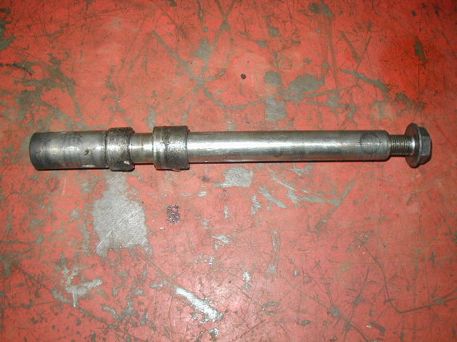

please look at these pictures and you can see that the brake disc is hitting the inside of the left fork?? with the spacers setup correctly????

The gap on my right hand side between the rotor and the fork is about 5-7mm.
