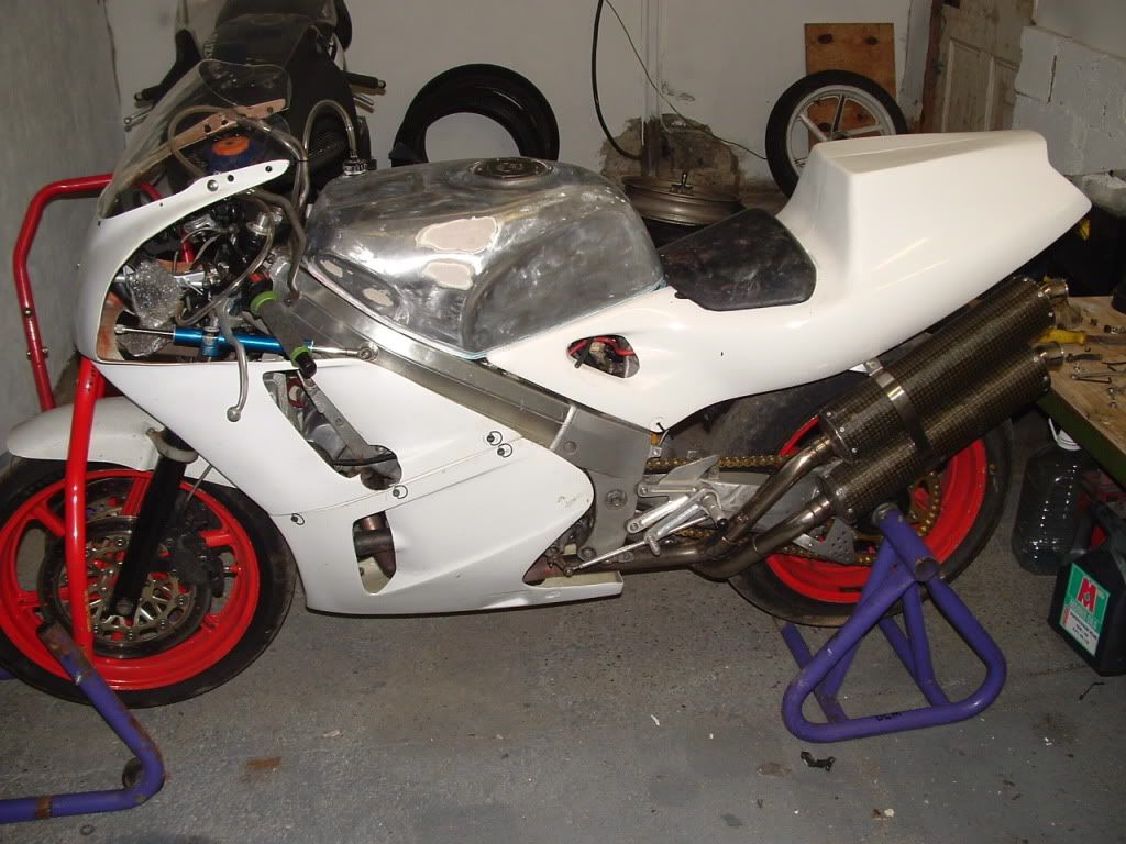

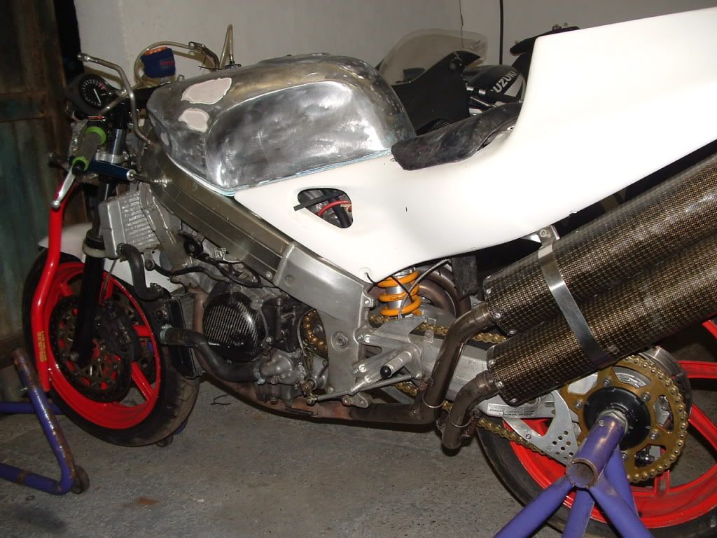

Needing paint.
Out on Saturday,so paint can wait,I'll prime the tank alright.
There must have been 2kgs of old paint on it.
I think a silver tank is the way to go.
The RVF seat unit gives a lot more room.
I have an NC23 front wheel to add,have to paint it black to match the rear I have.
I'm liking the original gold colour,but it's easier paint it to match the rear.
Thanks to all on here for advice and parts.
