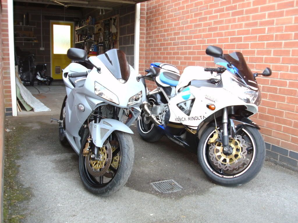

not much to see in the way of changes today but thought it would be good to keep the thread up to date. i have re-assembled all of the body after replacing the clutch plates.
so i thought it would be good to photo her next to my blade to see how she has progressed from early shots in the same position..
from this..
to this..
to present day..
what you cant see from the pictures is that i have fixed the speedo so i know will have an idea how fast i am going, put the correct bulb in to the correct postion in the idiot lights holder, so no longer does my oil read as neutral and my neutral go out when the engine is started.
my next job will be the electrics, so all four indicators work without causing the rear light to flash in unison, re-attach the ignition unit so i am no longer starting her with a screw driver! & the front brakes want attention as well.
i keep meaning to get a video up on here of her ticking over and going around the close, will attempt to do this tomorrow!
from this..
to this..
to present day..

mate
that bike looks awesome impressive work
any updates
alex
any updates
alex

I have looked throught this thread very fast and not read all but are you going to do anything about the seat side fairing meeting the tank whree it dont match up.

Very nice, should look along the lines of this, although yours are genuine panels :)
