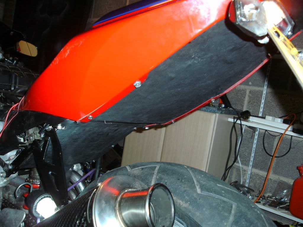

i am trying to keep this as up to date as possible, i promise! i have been wondering about what to do about the undertray as this is now mad of aluminum, i didnt want to paint it as i new it would eventually start looking poor, so i thought about different things and have finally gone with rubber.
I have used a sheet of rubber 0.5mm thick and have fixed it to the individual pieces of the undertray, i have only done the top two bits this evening but i think it looks good, will be water proof and professional.
anyway heres the pics
i have this weekend off so hope to have all of the body finally finished in the way of construction, then with a little bit of work for the mot...the paint job!

ok, not as done as i would have liked today, but the undertray is now finished:
http://i614.photobucket.com/albums/tt22 ... CT0700.jpg" onclick="window.open(this.href);return false; http://i614.photobucket.com/albums/tt22 ... CT0701.jpg" onclick="window.open(this.href);return false;
the rear brake light, indicators & number plate lights all now wired in along with the undertray built with a perspex part at the top to allow the number plate light to shine through

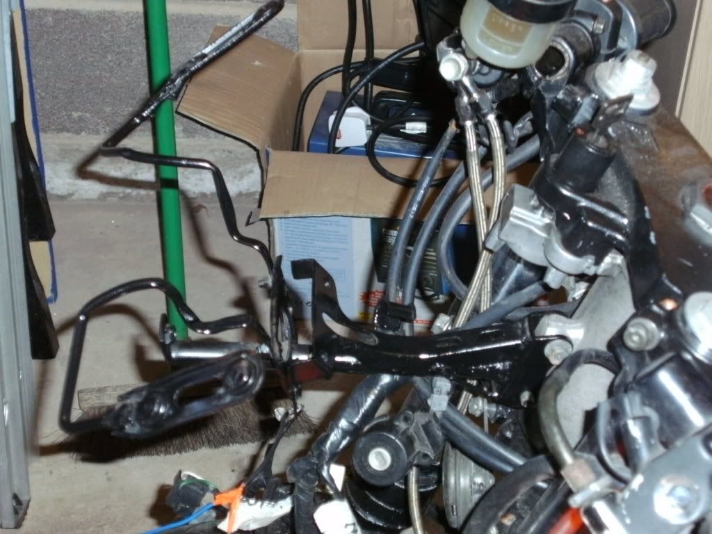

a new top fairing & headlight mount has been made using some original part from stock, coupld of bits from a nc24 screen brace and some strong steel tubing
http://i614.photobucket.com/albums/tt22 ... CT0709.jpg" onclick="window.open(this.href);return false; http://i614.photobucket.com/albums/tt22 ... CT0706.jpg" onclick="window.open(this.href);return false;

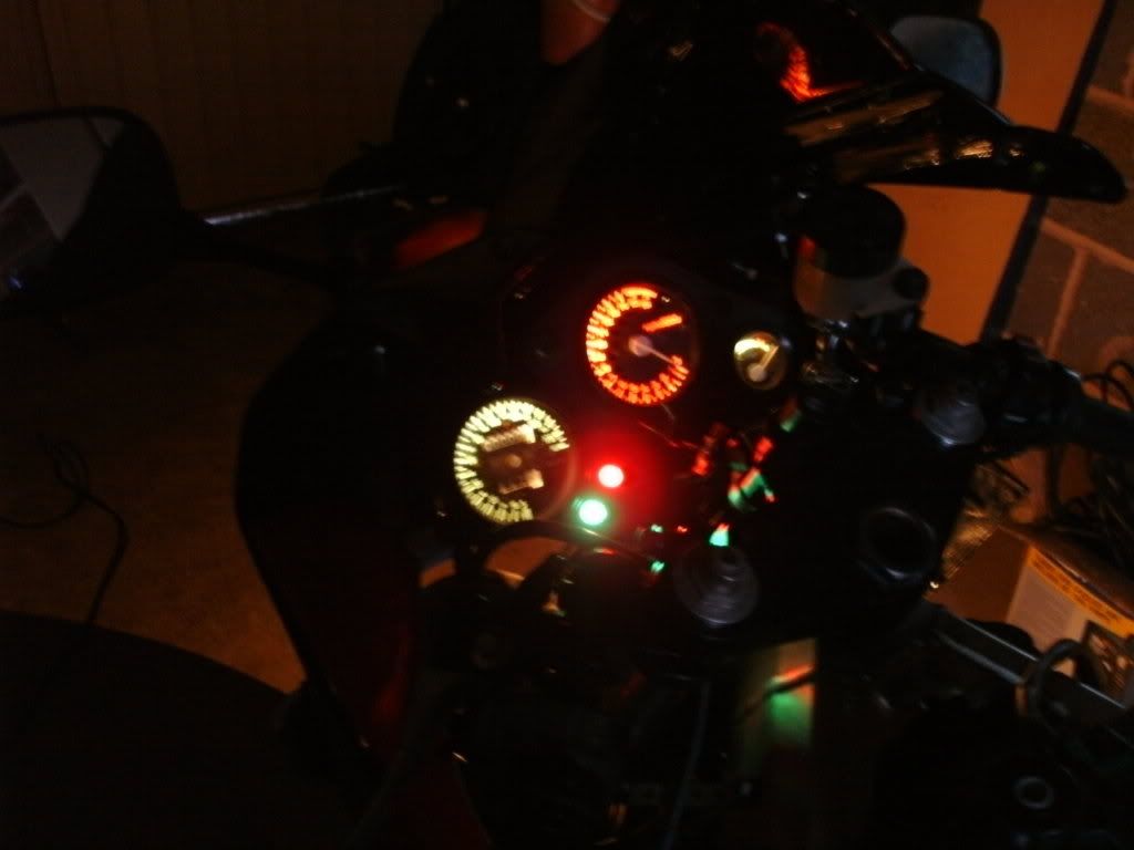

then finished the screen brace bu makign a bracket to hold the modified clocks, these are now slightly wider than stock so needed locating slightly further forwards than before hence the need i have for a longer speedo cable - thanks Deviant400 for the speedo cable swap! i have also wired up front indicators / lights and instruments dials
