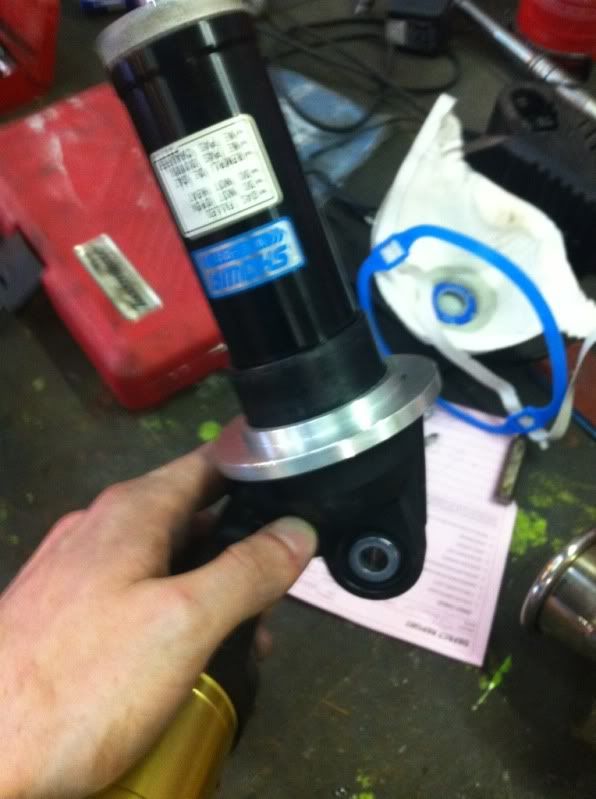

Re: Fitting a CBR600 rear shock to an NC30
Rang around a bit and couldn't find a non STD tapered spring so I'm fitting my 2.25 ID 800lb spring with a nice ally collar I've had machined up. New 7inch 800lb spring cost 30 quid from faulkner and my dads mate knocked the ring up for peanuts.
Will post more pics when I'm doing it. Also fitted uprated thinner r6 battery.
Spring is 7mm shorter than standard so o had the ring machined 7 mm thick
also has a step to seat the spring
