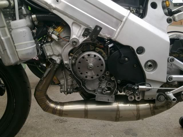

had an interesting and Educational afternoon at PROJEX in cradley heath.
there was a lovely 2T RGV 250 Kicking out 67BHP
was lovely bike but unfortunatley it was finishing just as we rolled up
