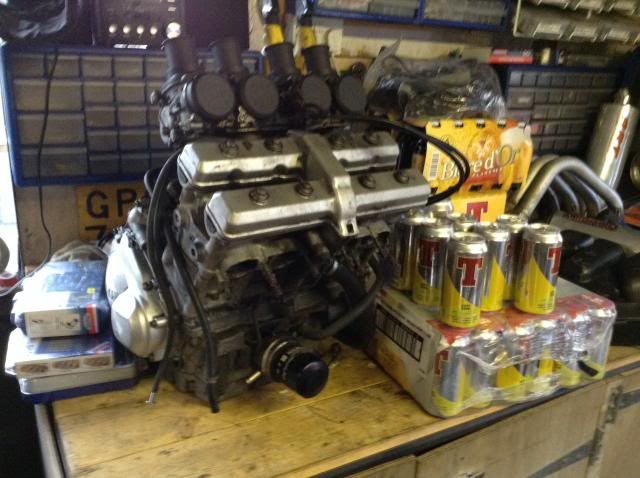

My 3tj has been sitting in the bike shed for 5-6 years now with a poorly engine. Lack of time and money prevented me doing anything with it, but now I have the time and the money to do something with it so it has been dragged into the shed for some much needed TLC.
600cc motor will be getting slotted in, single seat conversion and it will be treated to a full respray, not sure on the colours yet, but will be a race rep scheme.
Engine will be getting cleaned up before fitting, plenty of refreshments on hand.
Been off the road far too long. Will see the road this summer though, and hopefully Knockhill for a trackday.
Will have to get busy reading the 600cc engine thread to see what I'm letting myself in for.

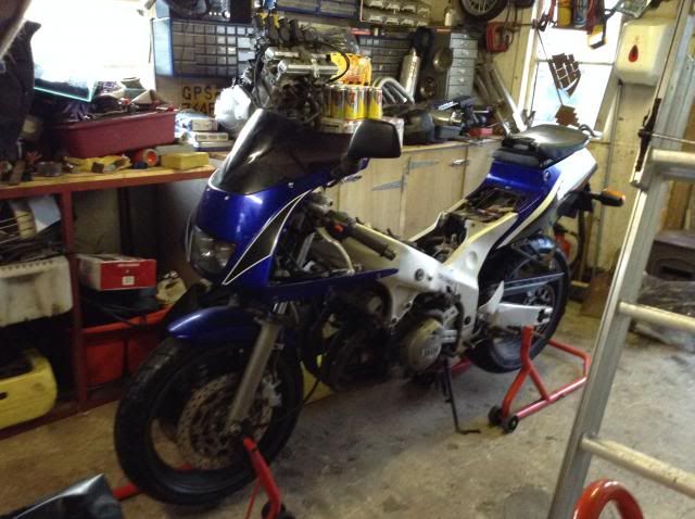

Was working late tonight so haven't gotten a great deal done tonight. Removed the seal & panels, rear sub-frame, nosecone and the exhaust.
Had a bit of a disaster with the headlight, knocked it of the workbench and smashed the glass, so that's the first thing on the "to buy" list on the whiteboard.
First job tomorrow night is to get the benches cleared up and dig out my storage boxes, as this would have prevented the headlight from getting knocked off the bench.
Second job is to get some carpet laid around the bike, as the concrete floor is not very comfortable on the old knees, and might have saved the headlight.
Third job will be to go and buy a docking station for the Ipod, as I ripped the buds out of my ears countless times ricking the cable on bits of the bike.
