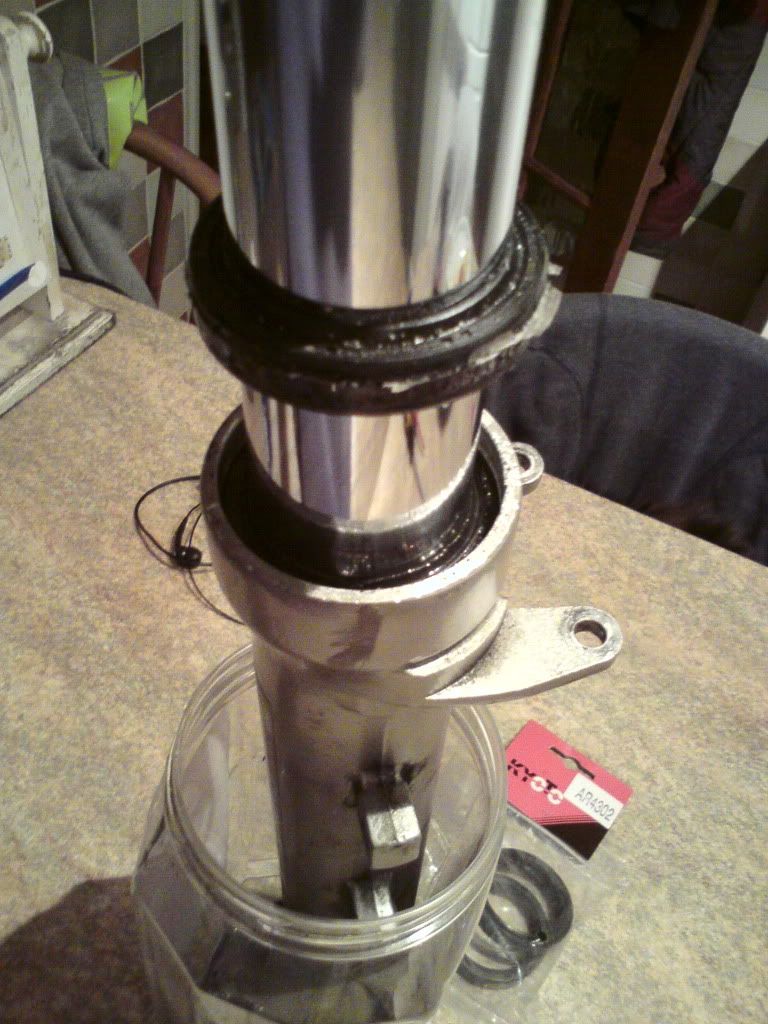

Found out it's 15oz or 443ml. I got these - 320502587485 for my friend. Turns out that the dust seal has been replaced with another oil seal & glued in :x The reason for this i found out after struggling to remove the glued in oil seal was that the retaining clip is missing :x http://i284.photobucket.com/albums/ll35 ... C00585.jpg

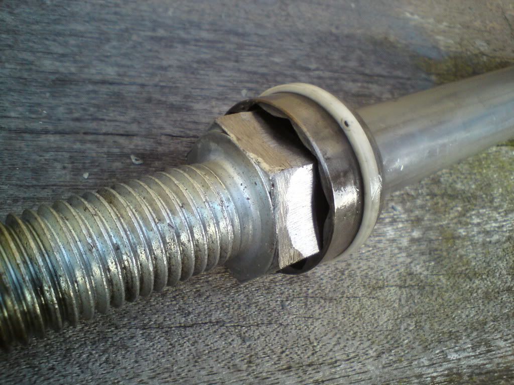

Found a 16mm bolt that has a 24mm spanner size head & welded it onto a piece of pipe. Only to discover it's too small! Looks like i need a nut to fit 5/8 thread. 28mm spanner size ;)

Post by hmplant » Sat Apr 03, 2010 11:56 am
To change the oil seals. Couldn't find a nut or bolt with head size 28mm but have a 30mm so i'm gonna grind down the flats till it fits;) Update it fits, pulled them apart & it should be 30mm or m20 ;)

This isn't the nut at the bottom of the forks on the inside ???
hmplant
Posts: 43
Joined: Wed Feb 24, 2010 6:30 pm
Bike owned: 85 GSXR7/11, 06 Bandit 12
Location: East uk
Re: how much oil
Post by hmplant » Sat Apr 03, 2010 8:58 pm
Yeah that's the one ;) Image
