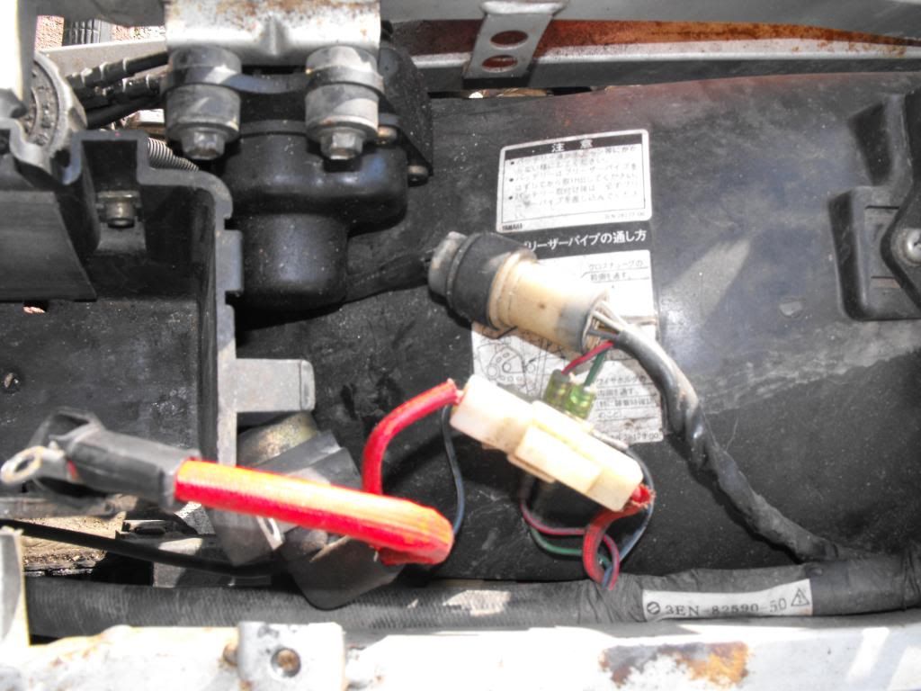

The main fuse is on the solenoid

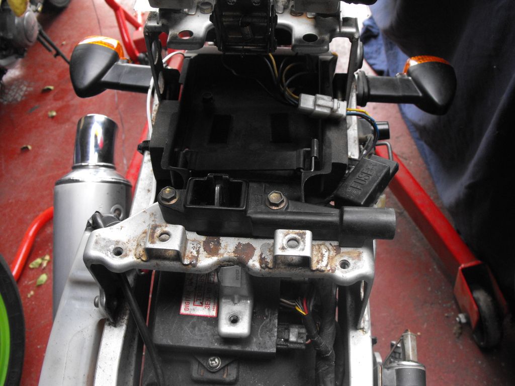

on the left side of the rear sub frame i have a black rectangular box with about a dozen cables going into it and next to that a blue cylinder with only a couple - i was under the impression the blue one is the flasher unit for my indicators? or is this the one you mean?

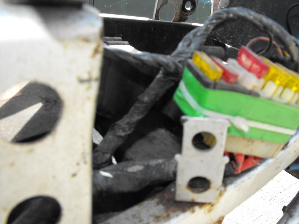

I think the manual you are using is more related to the earlier Genesis model (even then it is not 100% correct for grey imports in UK; only the US models) rather than being suitable for 3EN2 electrical diagnostics.
All the relays are built into one block rather than the separate ones you are hunting for (as in your first post) and is the one described by Evilchicken0.The only other one, is as you assume, the indicator relay.
I am unsure if the main fuse is built into the side of the starter solenoid without dismantling a bike !
I think it is held in the main fusebox situated at the rear. Two in the block are only being held as spares.
The spares manual only lists 10 and 20 amp fuses; no 30amp !

The power supply for the main fuse that is in the fusebox comes off the solenoid.
