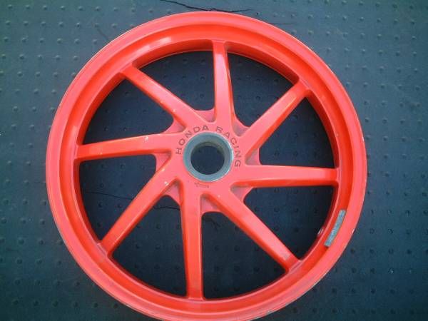

Between the two of us we have just about all the TTF3 parts then, I have all those parts you mention, just got this Mag wheel in the correct 4.5 x 18 size the other day to replace my RS250 one that ran the wrong way
