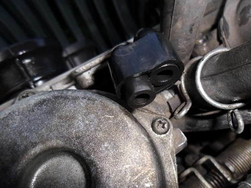

Just started to follow the guide by Cammo and turned the carbs to drain the float bowls and perhaps I turned then too far as fuel came pissing out of these tubes
What are they?

Dont know but thats where fuel pisses out if you dont drain them before turning them upside down ;)

Thought so!

fuel over flow hoses,
ive set the float heights wrong and had fuel pissing out of them!
