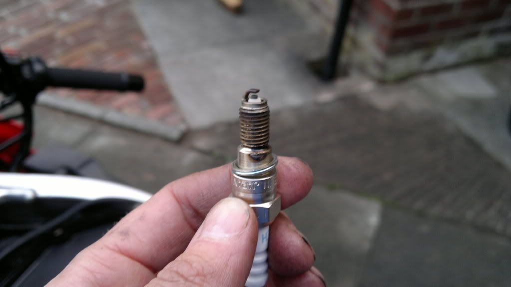

While I was at it, I pulled plugs 1 and 3. They were all new some 1000 odd km ago and they both had a slight bit of oil in a patch around the base?
No 1:
No 3:
I take it it's not a good idea to start it with the exhaust off?
I'll need to get that back on to run it.
No 1:
No 3:

Just looking at my plugs again, could the same gasket be responsible for the oil on my plugs?

And yes.. if its' leaking the oil could go into the spark plug recess too.

It does look like dried up oil down the plug holes, no?
