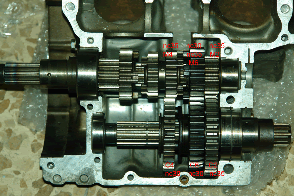

Here´s an old pic of a 35 shaft 30 engine. nc35 output shaft is next to C2
Re: NC30 Engine build, AKA Project viva Espana
Going to have to be a pretty big spacer to fit over those splines.

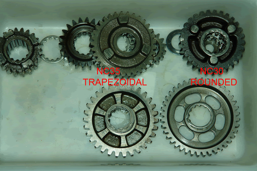

I think I posted about it in the old forum, but the thing was I was having trouble with my 2nd gear jumping, and couldn´t afford buying new honda gears. I guess this configuration will give me rvf gearing although using vfr gears, but it was not easy because rvf and vfr gears have different cogs. I finally found a cheap rvf gearbox, so did not mess with such a delicate mod, but it can be done.
