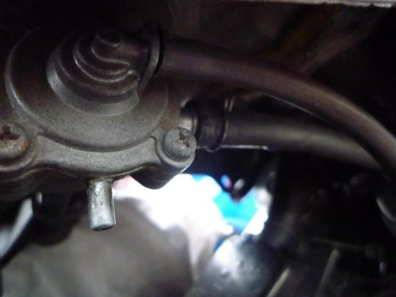

I was thinking about that when I woke up this morning, and I have a sneaky feeling I might've connected one of the pipes wrong. Am I right in thinking that the bit that sticks down shouldn't have a pipe connected to it? If it shouldn't then that's the problem...

pretty sure the vacuum line goes in from the side, not the bottom!

OK according to this picture I've connect one of the pipes to the part that is labelled "vacuum/bleeder hose"
So I think I've just been blonde and connected it wrong.

That picutres not much good, there are 2 parts labelled vacuum / bleeder hose.jo wrote:It would make sense to have started at first becuase there was enough fuel in the carbs to get it going, but once they're empty it's not going anywhere.
Which one did you connect it to?
Should be outside one.

The one that's pointing downwards in the picture.Neosophist wrote:jo wrote:Which one did you connect it to?

Ah,jo wrote:The one that's pointing downwards in the picture.Neosophist wrote:jo wrote:Which one did you connect it to?
thatll be your problem them.

Jo
as viewed from the right hand side of the bike...
Tube in the background is the main fuel feed to the carbs, tube in the foreground is the vacuum pipe - both kind of point in he same direction....obviously I am assuming the other end of the vacuum pipe is still attached to the nipple on the cylinder
Check your pipe work (ohh err) 3/4 choke as always and see how you get on. might take a while if the carb bowls are now empty but stick with it. Once it has fired up, let it warm up and reset your idle to a good level.....get booted and suited and go terroise the Fen folk
