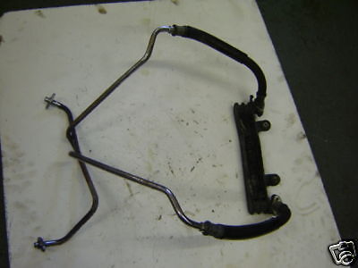

IF i've read the book correctly it's an 87 RH-II engine (would have been in a rothmans bikeDataRacer wrote:Yep that's an nc24 engine.nc30 madness wrote: my engine number is nc13e 1059825
Are your oil cooler ports blanked off or linked together?
You should be able to fit an oil cooler fairly easily (providing you find somewhere to fit it
