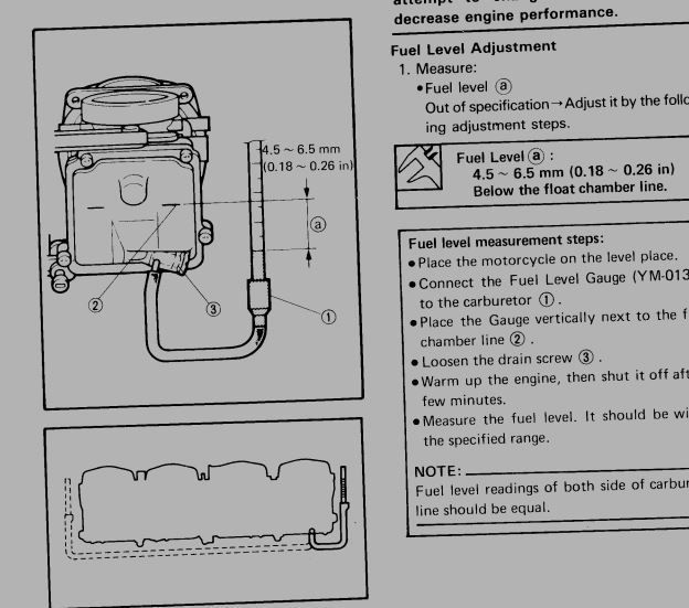

I am stumped about correct float height? At first I was caught between the later models that use a 23mm height - not possible in these carbs.. no room imo - so im sure im with the 13mm versions..
Manual states to have a float level 4.5mm-7.5mm below the two lines cast in the carb (using the drain hole and clear tube method)..
So i eventually got mine close.. at 13mm the bike almost sounded better.. I had to drop float level to around 11mm to get it closer to the spec..
Anyway - now the bike is still struggling to idle well - it keeps hunting, the dying, and idling rough.. at mid / higher rpms the bike sounds VERY smooth - revs climb smooth without hesitation..
So ive done TONS of reading - and about to conclude the emulsion tubes are worn - ALL the symptoms ive read point to these things wearing and dumping droplets of fuel into motor at idle / low rpms -
This from the manual:

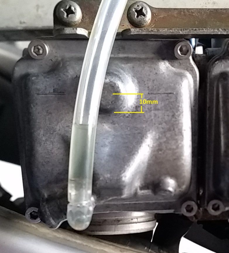

Mine before adjusting float some more:

Mine after adjustment:
