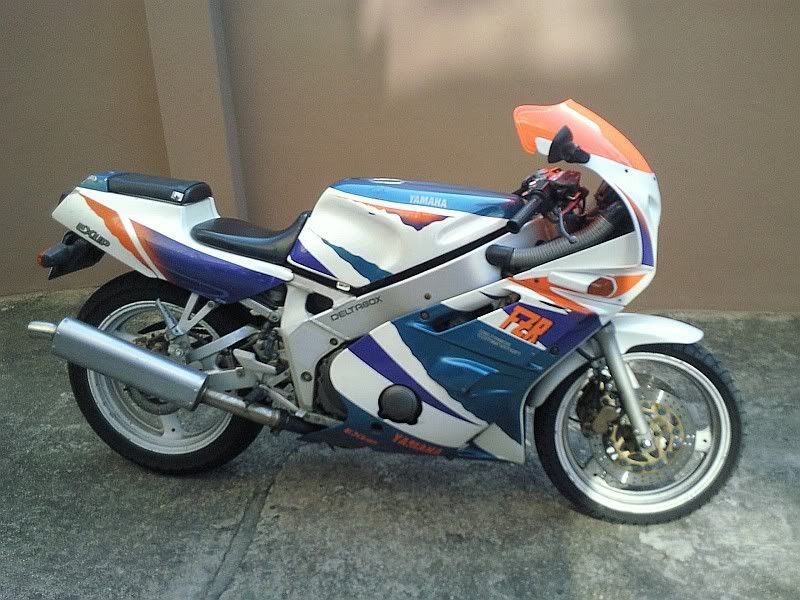

After bombing around on an Honda VT250FG for the past couple years I decided it was time for something with a bit more grunt, and a lot more grip. And here she is...
I've got a bit of work to do, so I'll be updating this thread as I go. At this stage I just want her running well for everyday use.

But it looks ok ... that screen looks like a 3en2 one because it extends beyond the fairing. I think Powerbronze do a 3en1 screen.

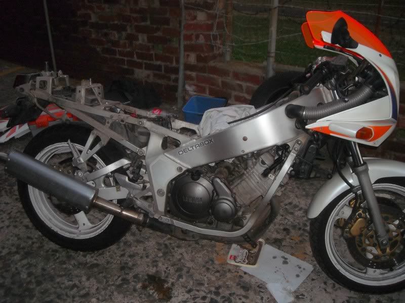

Quick update and 2 pics...
Checked valve-clearances - exhaust are all in spec, but almost all the intakes are marginal to too small a gap. Still need to adjust that cam-chain (thanks for info Taggy).
Got a long list of things to get through... but hoping to start her up this weekend and see how she runs with the carbs clean and the EXUP valve sorted

Like the colour scheme, but the screen has got to go........
Keep up the good work.....
