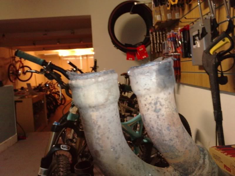

Stripping off the rads and the pipes tonight.
This is the end of the back section of the pipe that goes under the engine and connects to the downpipes from the front. Are these saveable or are they buggered?

Exhaust can be fixed!
viewtopic.php?f=22&t=14362&hilit=89+nc3 ... &start=110

That looks like a stunning transformation. I'll strip the complete exhaust off and send you some pics. It would be nice to keep it standard, save some money as well for all the other things that need doing.big stink wrote:Exhaust can be fixed!
