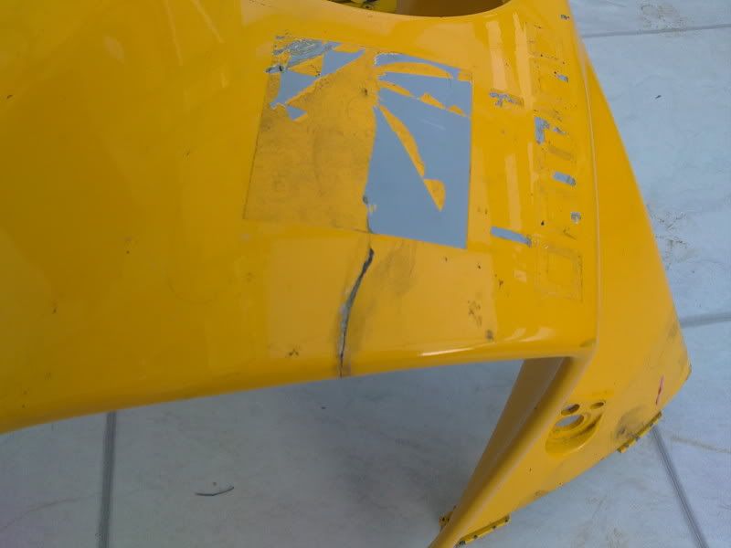

Anyway, here are the pics of the fairing and tank as it stands at the moment - I have a few weeks off work to sort them out.
Mister Donut Rep NC30
- Smev
- Posts: 858
- Bike owned: NC30 of course
Re: Smevs Bikes - Past and Present!

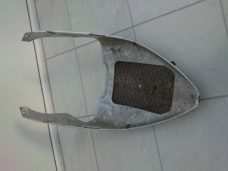

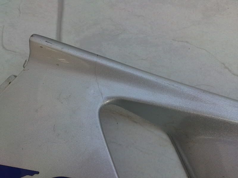

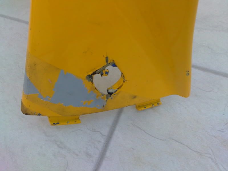

And here are a few close-ups of the areas I need to repair - one of the mids hs a couple of cracks appearing.
One of the lowers has the two upper mounts broken off.
The seat unit has a few lugs broken - all in the common 'weak' points.
and last of all is the top fairing with a couple of cracks.
All should be fairly simple to repair and I have loads of time (and chances!!) to perfect the art of repairing!!

I have managed to pick up some plastics for my rebuild that need repairing, you should do a right up on the repair methods for me, I mean every one ahem...
I saw it so I took it!
plastex is your friend kev, as your painting it get the black stuff its stronger.
- Smev
- Posts: 858
Curt, I was planning on doing a bit of a step by step write up on them anyways.
My mate who is a painter/sprayer/bodyrepairer says he sorts panels by using soldering irons, cleaning the area up from paint and grease first then using the soldering iron to work the plastic from each side of the crack or split. but without getting it too hot as it goes brittle.
I have also got a triumph top fairing donated to me by the local bike shop, to use to practice on, or to make some small brackets out of.
DM - I haven't used Plastex before, but just checked it out on the net, it looks pretty cool, especially the moulding bar bit. I think I may give it a go aswell.
