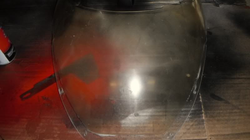

I decided to try and save the windscreen that came with the bike. It was seriously discolored so I tried one of those lens restorer kits for car headlights. It was a 4 stage kit (3M) with different grits of sand paper and polish. It gets an A+ for getting rid of the discoloration. As far as optical quality I'd give it a C+.
Not sure if the results show up on the pics:
Before
After
Tomorrow it's on to repairing cracks in the bodywork with Plastex

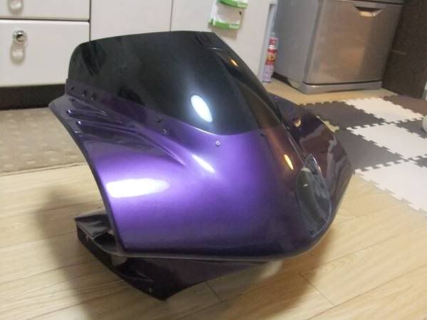

I told myself I was going to keep this thing as stock as possible but I couldn't resist when this Suzuka style upper came up for auction.
Hopefully I'll have it the next couple of weeks.
