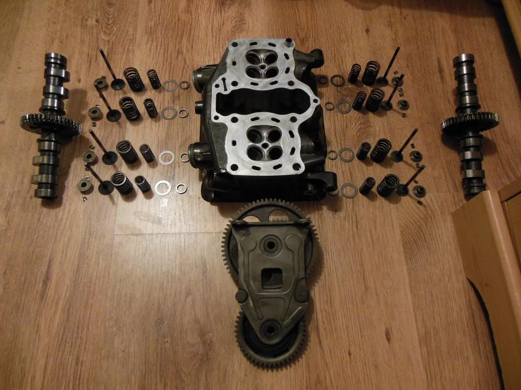

Finished the valve seats and decided to get a fancy photo of the head and all the parts:
I may have time to reassemble to engine tomorrow so i will get a few pictures to post up.
