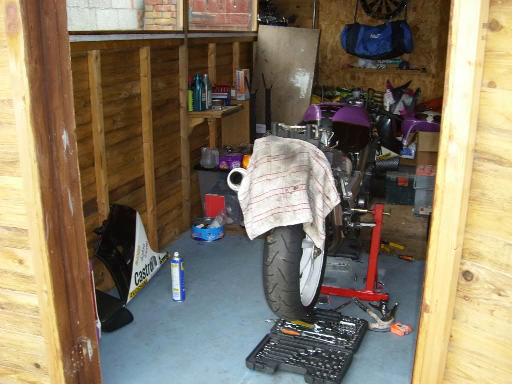

right, spent the best part of 3 hours clearing shed out this morning for the honda, should have seen the shit that come out, tip run me thinks. honda had a flatty so manedged to borrow a footpump and get enough air in her to wheel round the back. she s all tucked up now in the shed on her abba.
started striping pannels and fk me, what a mess, seized bolts, cracked fairings and lugs everywhere, shame. a good clean up and repair on most of them will see them good i reckon.
started her up with pannels off and after 1 min warm up noticed smoke coming from the back of the engine, hard to say where from but smelt rubbery?? a little worried. might be the exhuast gasket??? but got worse as i left it running so shut her down. anyone have any ideas?? iv hever noticed the smoke before and had her ticking over for 20mins some times but with the pannels on. so never saw it before. checked coolent, bottle was empty!!?? pured in about 200mls of water and blew through the bottle and noticed a slight drip from the rad cap!! dont think it was done up proper. i hope i havent cracked the cylinder cos of no coolent(it apperse there s not any anyway!?) spec with the winter we just had, maybe thats the smoke??

Don't want to sound like a tool, or make you sound like one - but I had the exact same problem when I replaced my exhaust. After the engine being on for about a minute, smoke started coming out - after 2-3 minutes it really started billowing out.
It was WD40. In order to get the bolts to slip in nicely I lathered them in WD40 and inadvertently gave the engine a coating, as soon as it gets slightly warm the oil burns off. Scared me until I realised what it was, sprayed some degreaser on the engine and gave it a wipe as best I could then took it for a spin - sorted.
Either that or your bike is going to explode.

im thinking now too the burn is just wd but will keep an eye on it cheers all who posted.
