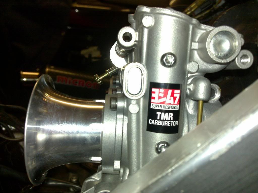

I think my dyno graphs speak for themselves. And with the hidden gems I have hidden in the loft I reckon I could do it all again in no time. Still got some fcr's, thinwall exhaust and can. Sp1 race cdi and timing rotor. Set of 90 sp cams. And a few other bits [emoji6]
