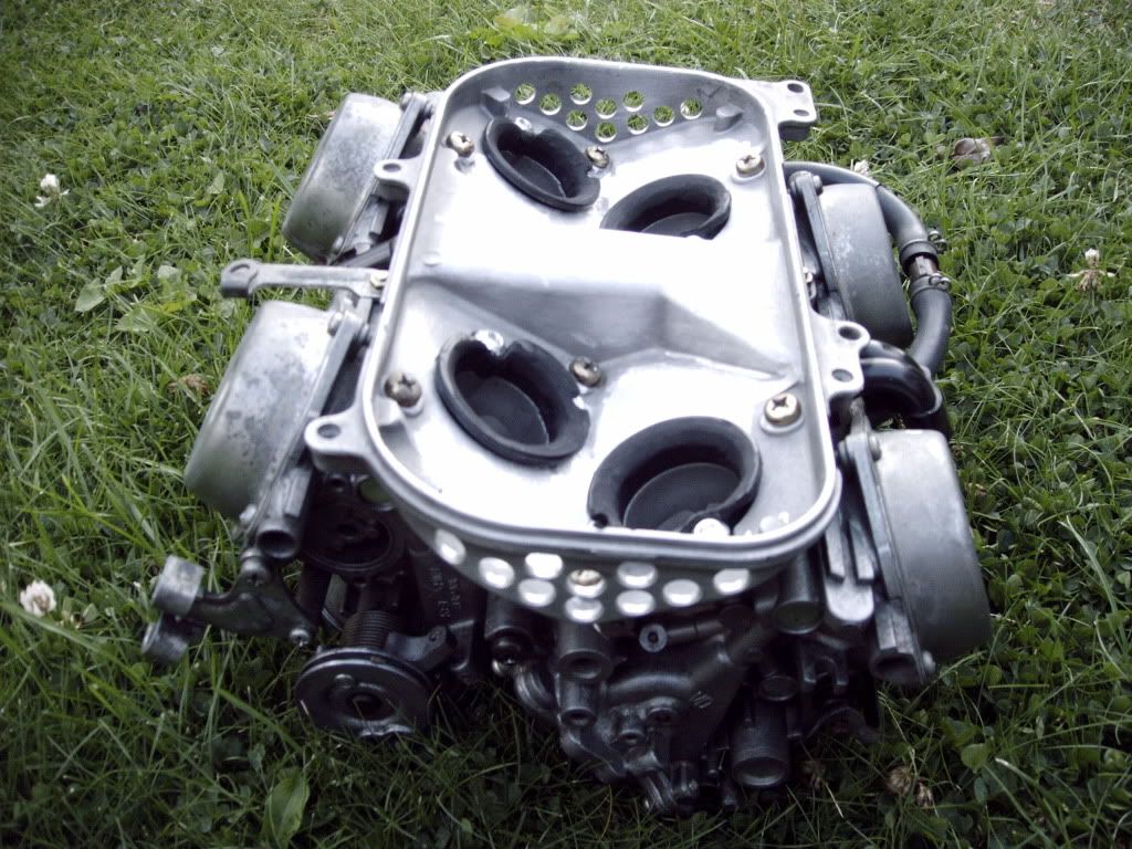

Abit more done today, i managed to get rid of the brace/ridges between the velocity stacks in the carb tray today as well as building the carbs back up.
Just have to save up some money then i can buy the carb kit and assorted jets

reverse cylinder jim wrote:Abit more done today, i managed to get rid of the brace/ridges between the velocity stacks in the carb tray today as well as building the carbs back up.
They look just like mine , HI5!!
