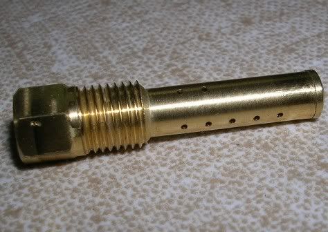

I think I have 145's and 147.5's in my little box of brass trinkets, I'll try them and see what happens. I need to order new head gaskets and a few other bits from Rick, I'll ask about the emulsion tubes aswell. I do have more than one set of emulsion tuibes that i could have a go at modding. Have you got a pick of the HRC ones that you could post up so I can see whether I'd be able to bodge a set please?

I'll get a pic up of the emulsion tubes in a couple of days, am away from home at the moment.

Here's a pic of an HRC emulsion tube:
The one pictured is a rear (5 hole). Basically, they're identical to stock items, but have 4 extra holes per emulsion tube - 2 on each side. The same goes for the front (4 hole). So each HRC rear emulsion tube has a total of 14 holes and each HRC front has 12. Hope that makes sense!? The additional holes are the same size as the standard holes. Basically you need these to get the fuel through when you're running big jets in an HRC set-up. Should be pretty easy to mod some standard ones - I don't think that hole placement would be overly critical.

That explains it superbly....
superlite wrote: I don't think that hole placement would be overly critical.
Nope, you can line them up with the first 2 std holes by eye and drill them easily. Just remember that brass is very soft, go slow with a sharp bit (I have no experience here, may need a specialty bit?!).
You WILL need these for the hrc carb mods to work properly.
