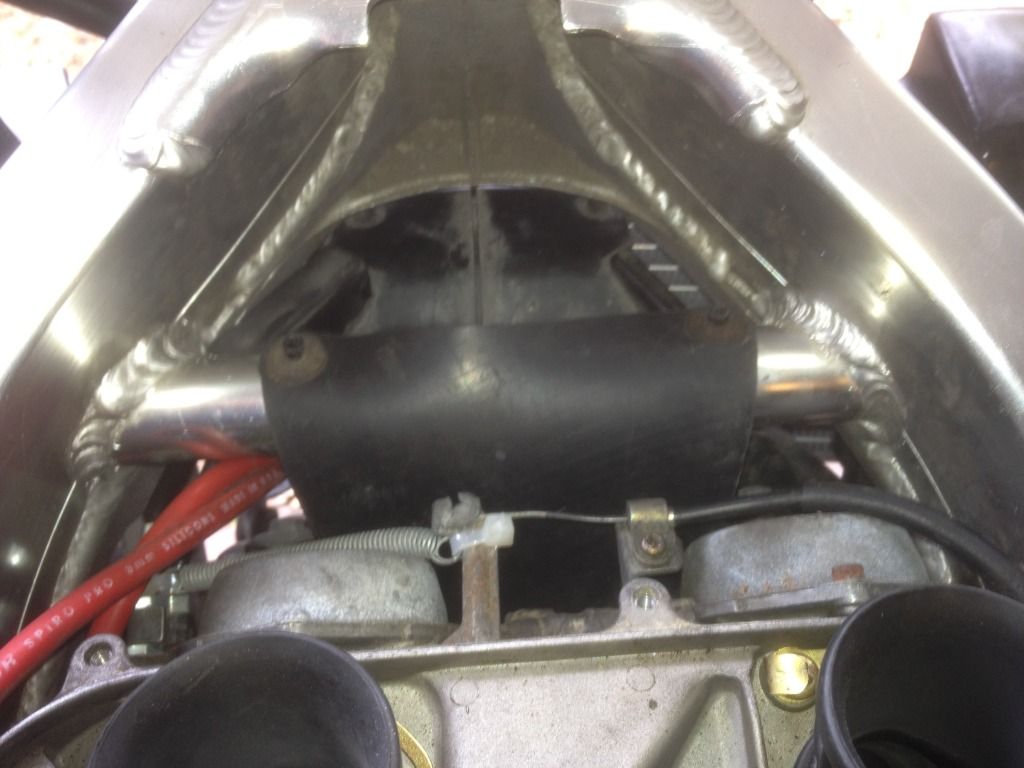

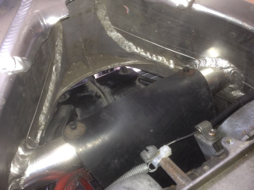

The flap is a pain to fit even with the OEM radiator, I will be surprised if it fits with your higher one.  If not, then make something out of plastic or cardboard, just to direct the air over the radiator and not through it.

Right so I've got the flap in place, just want to check I've put it in right before I bolt everything back together.
Piccies:
						Piccies:

FUCKING YES!!!!!!
The rubber flap fixed it :D
Kinda new even as I was going through town to get to where I could give it some stick, the power delivery felt better and sharper.
So when I gave it some stick, it went like stink like it should :D
