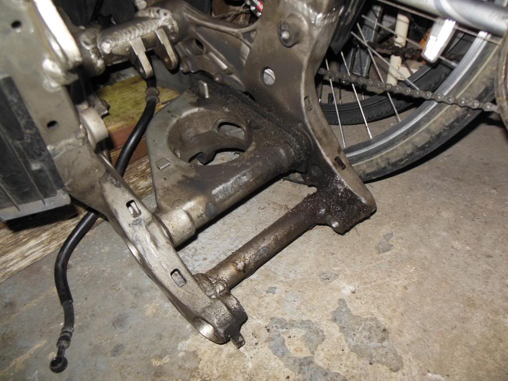

Given the frame a bit of a scrub. Before,
After,

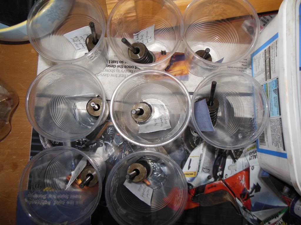

The water cooler at work donated a few plastic cups which make perfect sized containers for the valve components

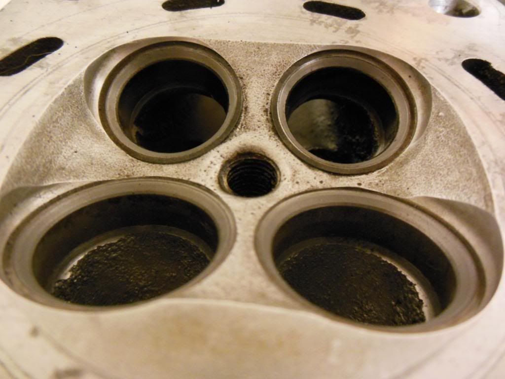

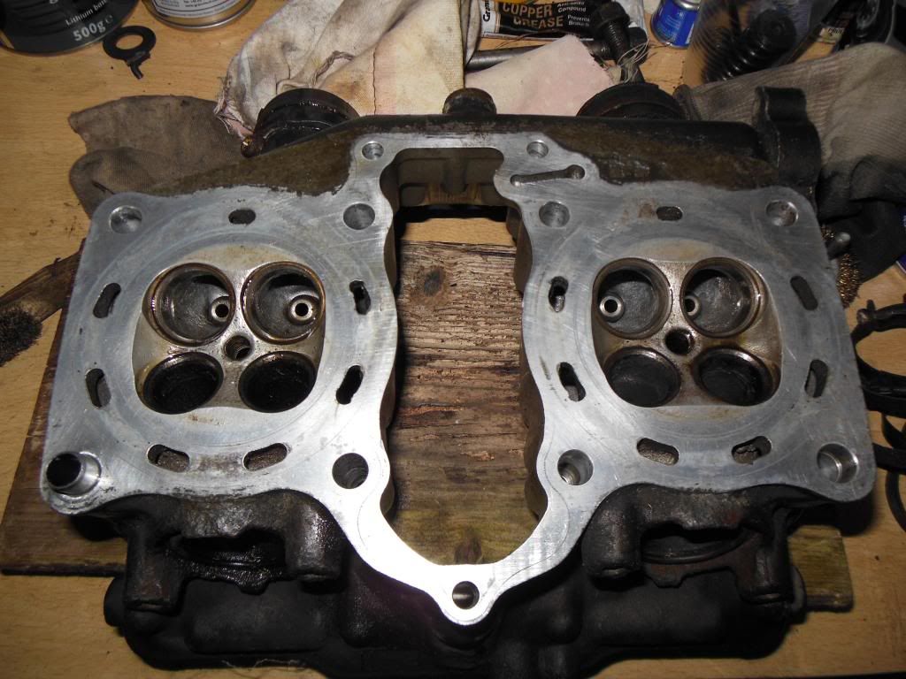

Small update for now, got the rear head from this:
To this
Before i realised that this had happened whilst the engine was still being used!
It seems that the valve guide has slipped down, anyway it wouldnt have been worth repairing the head, so i spoke to Tony and we swapped my bad head, for one with 2 broken valves but crucially no damage to the main body. So i will swap my good valves for the broken ones and we should be ok with that.

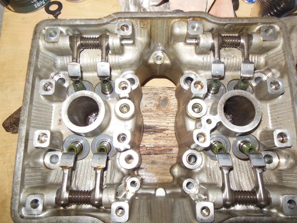

Gave the front head a good clean and have lapped in the valves, alls thats needed now are stem seals.

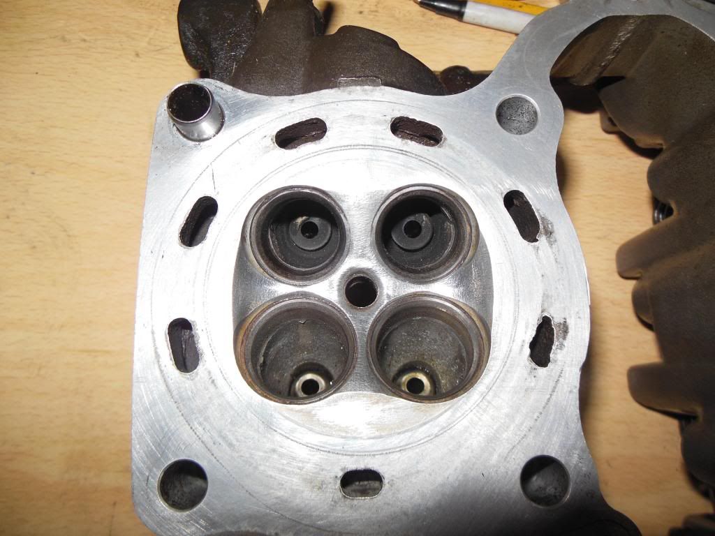

Got started on the replacement head.
Bent valve, Piston had spun a main bearing wrecking the valves in one cylinder luckily i have 8 spares to choose from .
