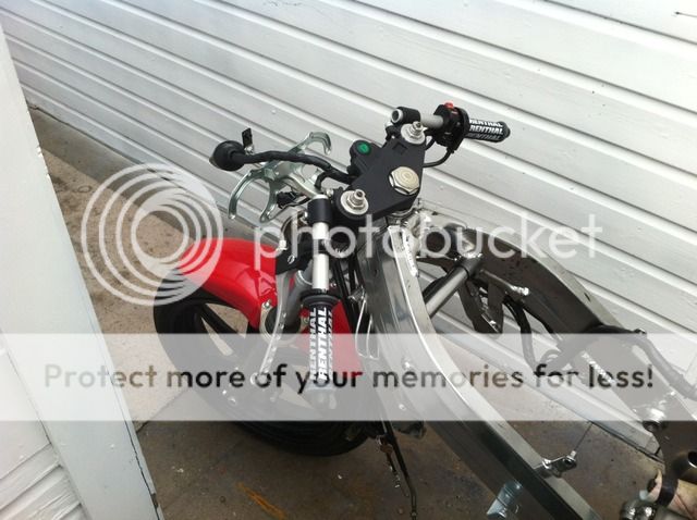

Turned this mess into something usable. The Reg Rec plug was chopped off the other loom and wired into this one. Aswell as the whole lot being cleaned and retaped.
Mounted quite a few bits here, lhs grip glued and lockwired on, rhs switchgear mounted (hole drilled), quick action throttle and clutch cables.
How the bike sits at the moment with its loom in the correct place.
Few final parts of the loom to be cleaned and mounted later.
Need to get a box of parts zinc coated now before I get the engine in.
