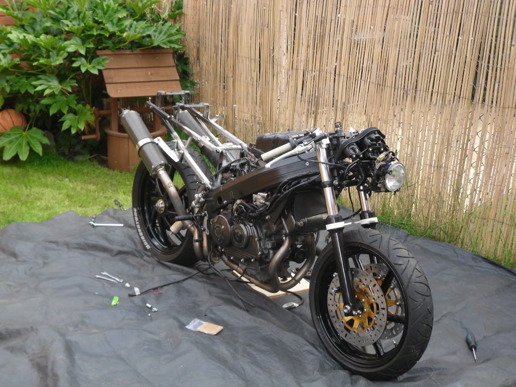

as its a nice day and work finished on time i dragged the bike out the shed to do a few small jobs , so here she stands at the moment , i wasn't 100% sure about the black powder coat but with the wheels on and out in the day light i 100% love it love it love it, :grin:

spare subframe on as the good one is still at the coaters , test fit the pipes , all looking good , just waiting for the good one to come back , then i need to source a good lower rad as mine is beyond repair , fill the system and fresh oil and filter , before i can fire her up :peace:

Superb work, looks ace.
Is that System the one that Marcus had for sale?

no its TSR titanium jobbies :tits:

Awesome. You going to polish up that system?
Loving the all black. As they say, once you go black, you're in a wheel chair...

Deviant400 wrote:no its TSR titanium jobbies :tits:
Have you herd what they sound like yet?
Re: Deviants nc30 strip and rebuild
Hadies wrote:Awesome. You going to polish up that system?
:o wash your mouth out, thats one way to wreck the finish of Ti
Bike looks bloody mean as mate, i really really like that. What you doing with the bodywork? i think a white scheme of some sorts would look amazing on that.

you have totally read my mind tony , white rc45 seat and tyga suzuka front end , i have the front end but gav is awaiting seat units so will send me one on when he has more in stock,
and no i wont be polishing the system , it looks the bizz just as it is 8-) but im desperate for a bottom rad looks like it will have to be an ebay one for now :? cheers for the comments chaps
