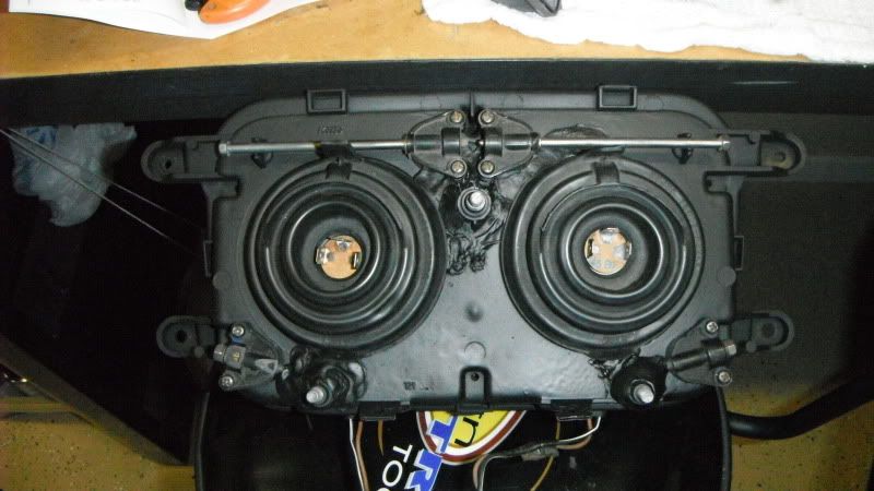

I gave up trying to find a headlight in good condition so I repaired mine. I know it looks like a 3 year old did it but it had 3 gaping holes. I tried to make it look pretty but it wasn't strong enough and I got frustrated and globbed it on.
I'm working on assembling the carbs and cleaning the rust out of the gas tank.
