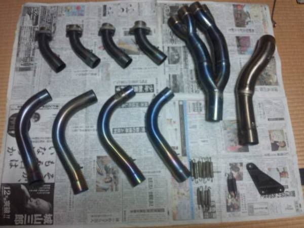

I did something very naughty, won this on Yahoo Japan :whistle:

Ti Akra system is here, sent friday, arrived monday, that's a good service for you!

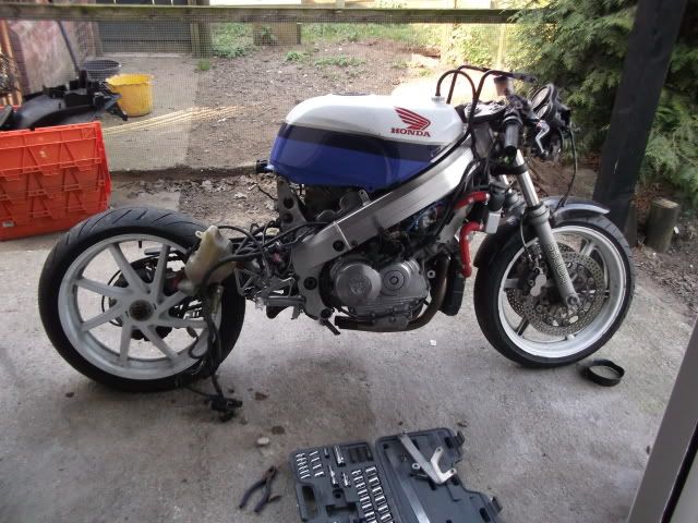

The tear down of the NC30 has started, I'm 95% sure the swingarm wasn't damaged, there are no creases or buckles in it at all, and using a piece of wood the alignment checks out. I've chucked on my old rear wheel (REALLY scabby now after starting to nitromors it) it has a very nice BT92 on it, so will be looking out for a nice white rear wheel to have it swapped onto.

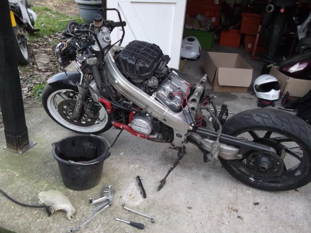

Right, picture time!

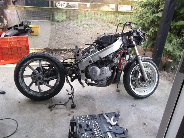

Started by getting the main impact area stripped down, as you can see the wheel has totally had it, I cut the tyre off so I wouldn't be tempted to use it again, even as an emergency one.

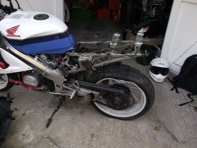

Most of the back end is off, it would appear the swingarm is actually ok, I couldn't see or feel any creases or buckles in it, and the hub is still smooth. The rear brake is currently off so I can give it a scrub, it's pretty damn manky :down:

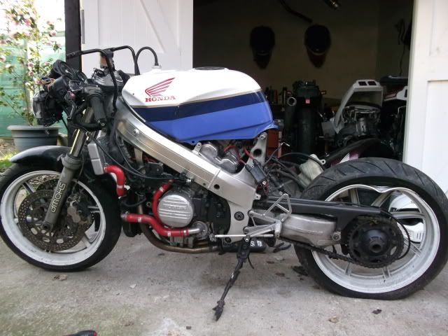

Got it back to a state of being a roller, this is the original wheel from when I first bought it 18 months ago, it's just REALLY scabby because I started to strip the pain before I got hold of a white wheel.
I reckon to get it as far as it is now took me 2 hours with plenty of breaks, cutting the old tyre off and taking it easy :up:

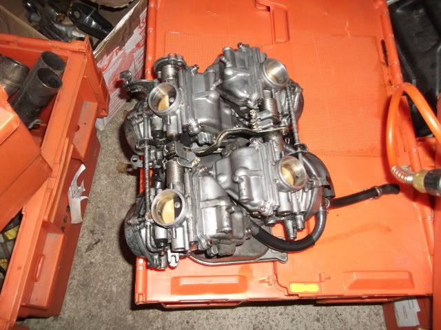

I also got the carbs off, I'd not drained them after the crash nearly 6 months ago, so was worried they'd be gummed up, but are spotless inside, I did give them a quick blast to get rid of 20 years of accumulated grime and crap, not perfect, but without stripping them right down, it's a decent enough job, everything works smoothly :mrgreen:
I've gotten the radiators off, tomorrow will likely consist of me very carefully turning the engine over by hand after lightly oiling the bores, just to make sure nothing has seized up.
