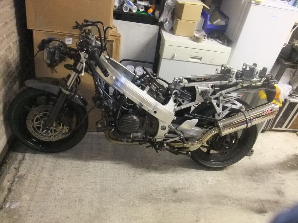

Re: What did you do with your NC30/35 today?
Been busy. Fitted taper head bearings. Fitted low beam relay & UK bulbs. Stripped rebuilt gear selector box (not shifting too well going up the box, couldn't find anything wrong
). Rebuit carbs, litetek seals, needles shimmed, slides drilled, rejetted. Fitted the whole lot. Modified the airbox base panel (not sure if it'll do much but read somewhere it was worth a go):
Put everything back together. Modified the fuel tap to get rid of the Vac side of it. Got 3 more inlet Vac take off tubes and the blanking rubbers from Dave Silver so now I've got Vac take off pipes to connect the guages to (makes carb balancing a bit easier. Balanced the carbs. Flung it all back together and took it for a blast :-)
Rode it for twenty minutes, cleaned it for 45
