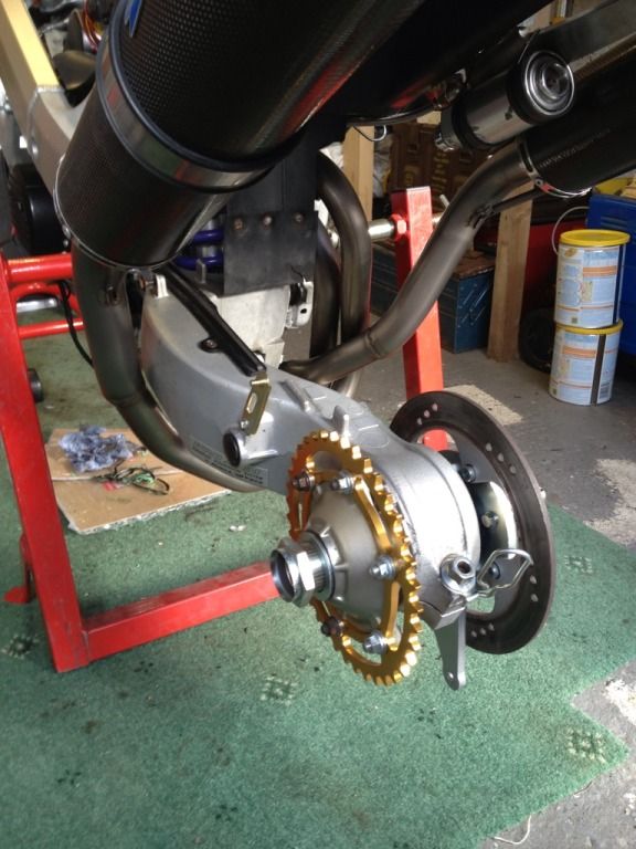

Looking good mate, what system do you have fitted there? Looks like theres not enough clearance for the extra pipework for it to be a TSR sp1 style so im guessing a Beet Ti half?
- Zippy
- Posts: 684
- Location: South West
Re: Zippy's RVF
It's a titanium TSR SP-1 system
Re: Zippy's RVF
The rear pipes are just loosely fitted, I know from experience that you don't tighten anything on these systems until everything is in place, these are most likely the trickiest systems to fit and get right I've come across

Drunkn Munky wrote:The rear pipes are just loosely fitted, I know from experience that you don't tighten anything on these systems until you everything is in place, these are most likely the trickiest systems to fit and get right I've come across
In the plastic bag mate are the correct nuts and washers to space the end cans out properly. Hopefully the rvf subframe isn't too different.

Oh fair one, does the pipe from the front cylinders pass between the rear headers and the shock or go outside? If im honest after reading other peoples threads about fitting these systems it seems like more of a ballache than fitting the JHA!

Then came the time consuming part. Fitting the TSR SP-1 Titanium system. Knowing there was going to be a clearance issue I already bought a set of smaller style indicators from Rick Oliver. However fitting the system took Tony a large chunk of his day.

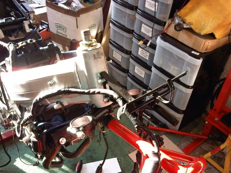

Tony was putting the front end together at the weekend and discovered that something was out of line as the fork legs were about 1cm out at the top yoke. Well we hope we've narrowed it down to an out of line bottom yoke so that is going off to Maidstone motoliners to get inspected and straightened if possible.
Here's the offending article in question
