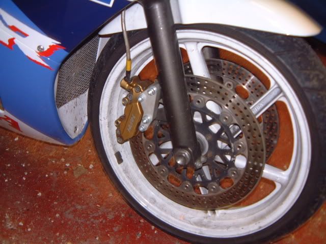

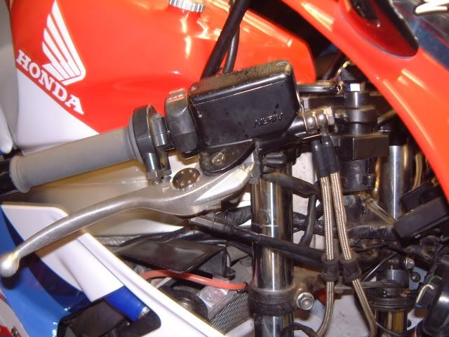

some piccies of the new brakes, the cbr600 master cylinder is mahooosive! only just clears the fairing
but they will be coming off again soo as you may be able to see the lines are not routed correctly, they came all connected witth the fluid n so just put them but i will take the lines off and route them behind the throttle cables and clamped to the stanctions as the originals were. + one of the resevoir bolts needed to be drilled out and replaced before i could take the cap off (but thats done now)

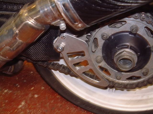

I also fitted a shark fin to get the bike ready for trackdays (i know its not needed) and possible racing, shown here

Re: steve hislop rep?
Me likey very much.
What exactly is the fin for?
