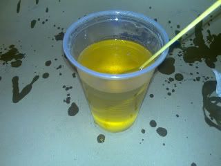

Well, beat me with a broken bottle, my balls are feeling a little weighty right about now.
Been playing with this carbon/kevlar stuff over the last couple of hours and it just might work.
Forgot to take a picture as the cloth was being applied but remembered the camera after the shrink tube had been applied.
It was serious head rush stuff as the fuse popped on my hot air gun as soon as i started.
No this is not a sample for the doctor but the learning curve was running high, note to self use a lot less resin. I could have done 10 with the amount i made but i was worried about not having enough at the start so went a little large and had this left over.
So, with the sleeve removed it looks flippin good, there are a couple of marks that i think are due to the gun packing in at the important point in the layup but its very usable and 98% there so as a first attempt im over the moon.
I have not attempted to remove it yet, may need to cool the ally core in the fridge but will leave it till tomorrow and may be take it up to the men in the know for a little advice. :peace:
