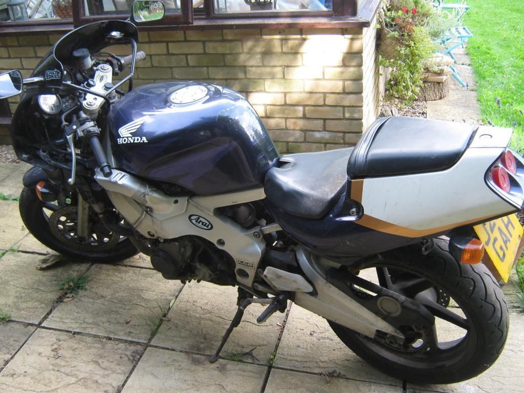

Just as a reminder, this is what i started with:

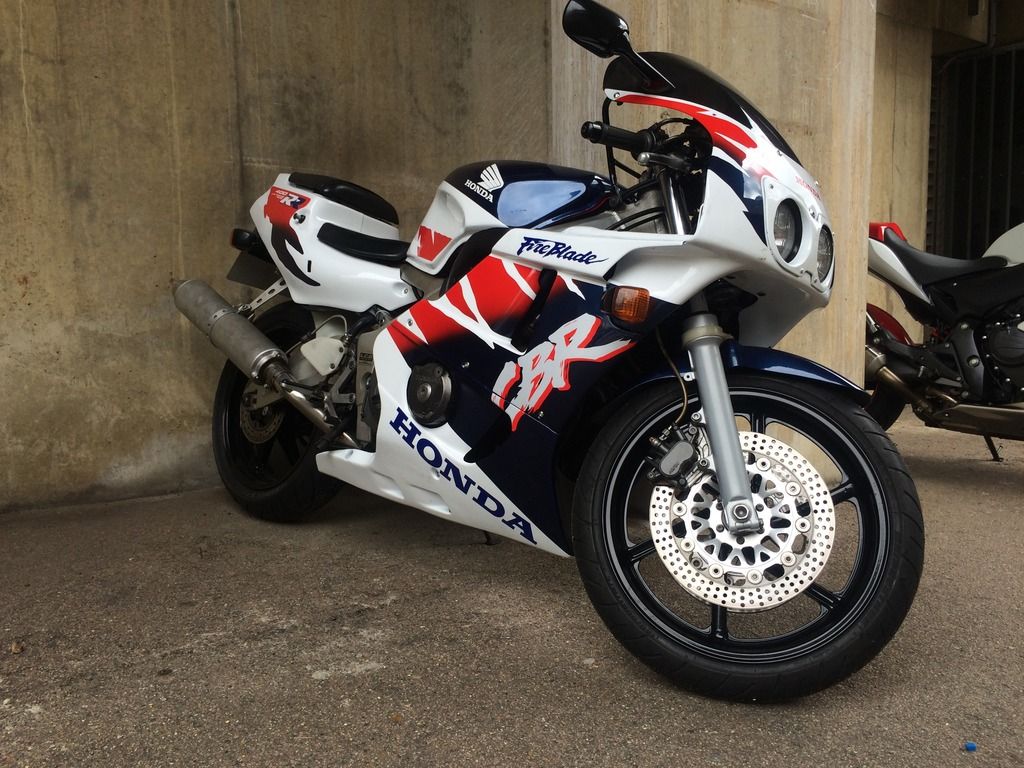

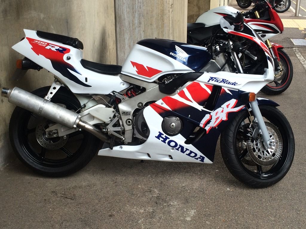

And after much love and attention we have the finished article...
Its been a really great project and i've learnt a lot along the way. I was really quite lucky with my find in that i had a very decent machine to start with, Ive barely touched the engine apart from the carbs. All other consumables, fluids, bearings, forks, suspension, some electrics, wheels and fairings have all been refurbished or replaced so it should be good for a long time now. Ive only had a couple of short rides but im completely smitten already

Brilliant, the fairings look good, most people would not guess they were aftermarket and I think the fit looks ok. The dummy tank looks fine as well, what was it like to fit and what is the the fuel cap recess like?

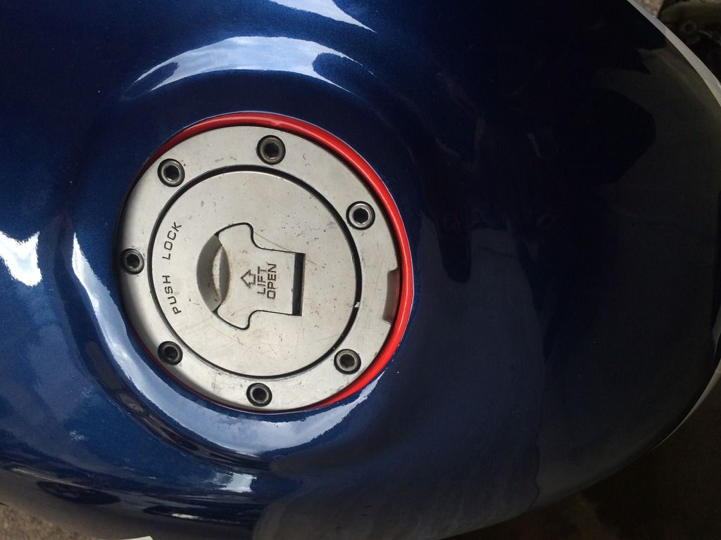

Thanks im very happy with how the fairings came out. The tank cover was really easy to fit, it just slides straight over and is a very good and snug fit. The fuel cap recess is the only bit thats not quite perfect but it was always going to be an issue, here is a pic from above:Durka Durka wrote:Brilliant, the fairings look good, most people would not guess they were aftermarket and I think the fit looks ok. The dummy tank looks fine as well, what was it like to fit and what is the the fuel cap recess like?

I wonder if you could do something to tidy the edge up of the filler cap, maybe a large rubber ring or plastic just to frame it better?
- Posts: 53
- Joined: Sun Sep 21, 2014 1:54 pm
Re: NC29 project
I have been wondering about that, maybe some sort of foam ring that would compress to give a snug fit might work. Id really love to get the tank painted, so far ive had one quote for £200 which includes decals... hmm
