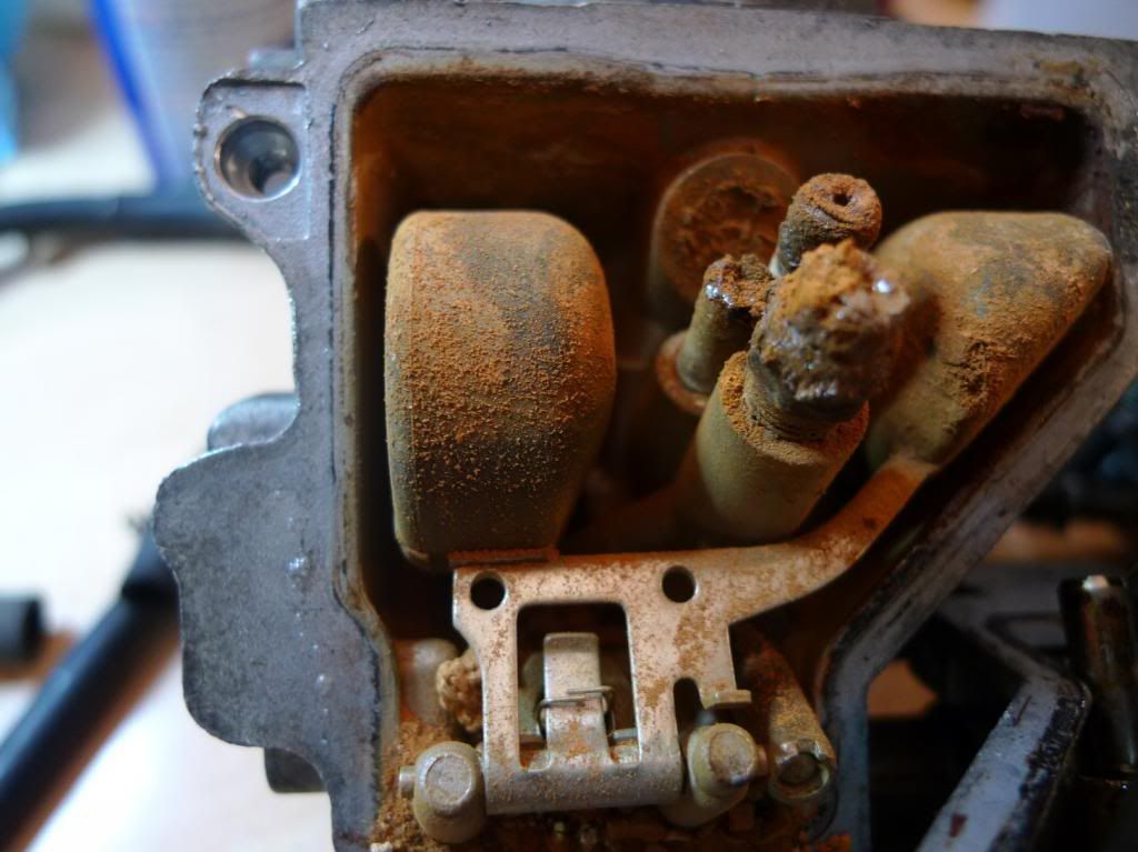

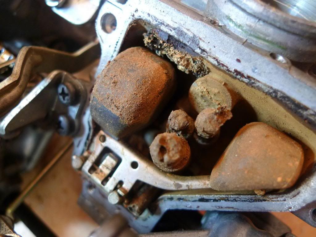

I got my carbs sonically cleaned and they've now siezed - corroded inside in places I think and the jets also just plain siezed in - no change of getting those soft brass things out without destroying them. I've got pics of that but it's too depressing ... so I'll do them later.

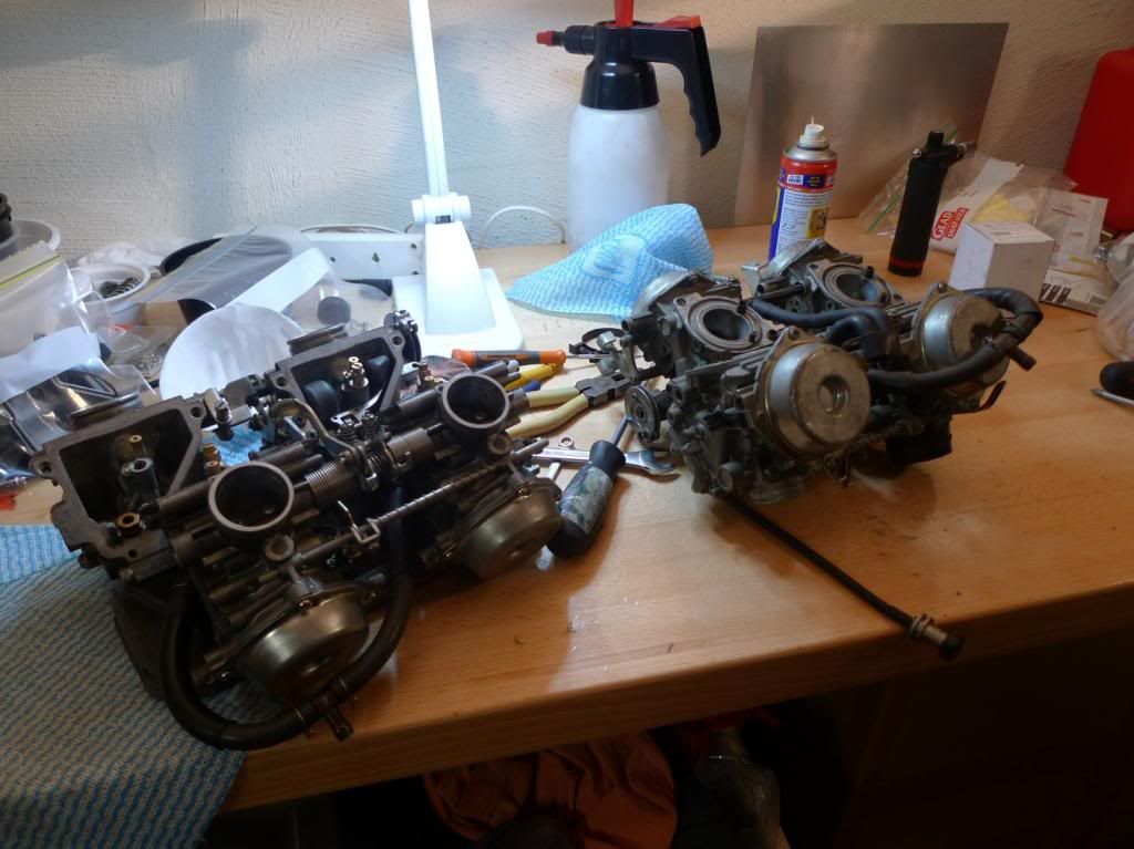

So, a replacement set arrived today and I set about attempting to strip them straight away.

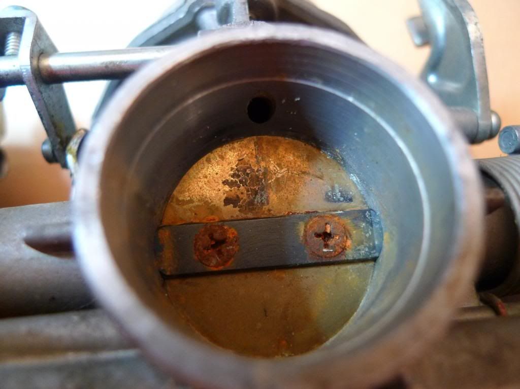

Hmmm .. this doesn't bode well ...

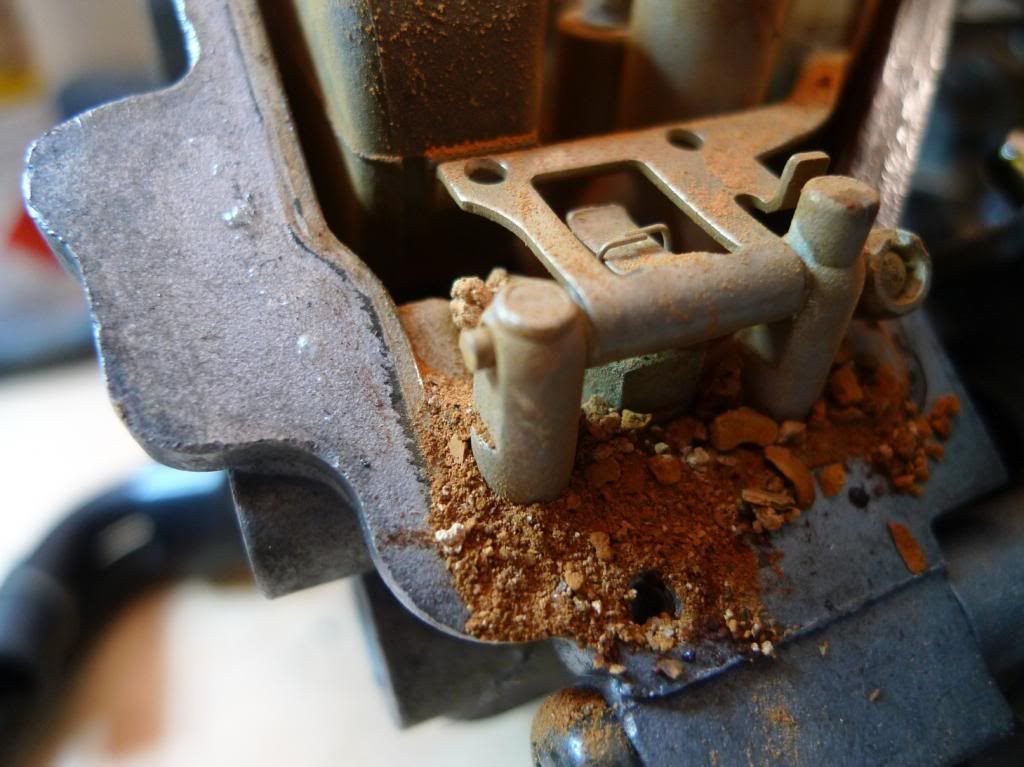

Yikes .. neither does this ...

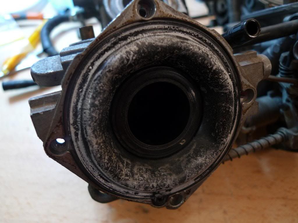

And after much screwing about trying to get a float bowl off ... I get this. Geeez:

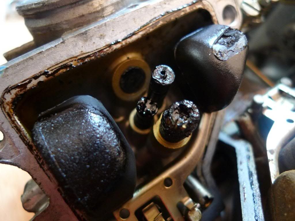

Yuck. And the next one looks like this. F*ck.

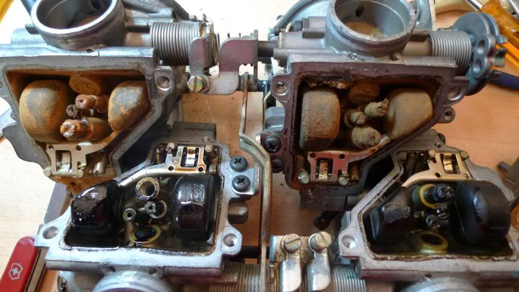

.. and the next like this ...
... and the last was also a disaster. Here is the happy family:
I have them soaking in petrol at the moment but I doubt I will be able to salvage any of those at all.
I'll be asking for my money back tomorrow ...

The nasty pictures above are actually for the *replacement* carbs that I bought.
But in terms of the sonically cleaned ones:
He used a citric acid based solution that was the colour of dark tea (no milk!). He said it costs him like $800 for about 10 liters of the stuff.
The carbs were dissassembled but I think the solution and the sonic intensity must have been very aggressive - it took the plating off some bits as well.
Within a week they had started to corrode with powdery puffy nodules all over so I called him and he said he forgot to 'oil' them - said he normally used WD40 or something similar to spray them after blowing out passages with compressed air and drying.
I did same and then re-assembled them. But, while they were sitting for a month or so stuff just seezed up. The pilot jets are just locked in and I have already destroyed one trying to get it out - hence needing new carbs.
They are seized enough that trying to turn the tops of the pilots just mangles them. I have dremelled new grooves, and then they just break as well.
Is there a magic way to get seized (brass) jets out of a carb?

those replacement carbs are insane...did you dig them out of the desert or something!?
Something aint right with that ultrasonic cleaning, i haven't had it done personally but everyone i've heard that's had it done on here and friends havent had any issues like that.

Sorry, I misunderstood. The new ones look like something out of a post-apocalyptic movie
StrayAlien wrote:The nasty pictures above are actually for the *replacement* carbs that I bought.
