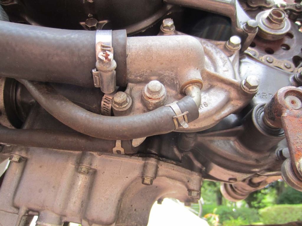

HRC water pump cover mod

Do the HRC/nc23 oil coolers have a direction of flow? I cant see anything marked
Which would be the flow and return from the modified pump cover?

Re: HRC water pump cover mod
I don't think it matters.
Taken from liam's SS/SP NC30
That setup would terrify the snot out of me. Lots of hot bits waiting to touch each other and melt if you get it wrong. And knowing me, I would... lol
