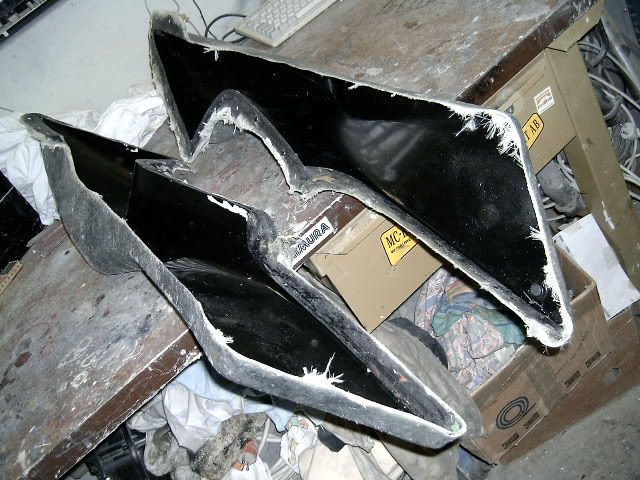

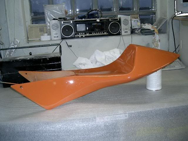

The base for the tank/seat combo is easily available through any Honda RS125 daler, as it's an RS125 -04 seat unit mated to an NC30 tank...just put in a few (hundred) hours shaping the thing...or buy a copy from me when it's finished. Mould making begins this upcoming week, so hopefully we'll see the result i a few weeks from now. Just remember, you'll have to cut and weld the frame a bit to fit the thing.

Well, the -04 onwards RS125 is indeed the base from which I made this seat unit. It's then morphed a bit, and joined to a PU foam shape that began life as a coarse copy of an NC30 tank...so quite a bit of work.

As I was cleaning up my attic I found the old mould for the first incarnation of the seat unit, before it was merged to the NC30 tank. Perhaps this mould would be a good starting point for your seat? If so, I'd swap the mould for a raw copy of your airbox. Good idea?
