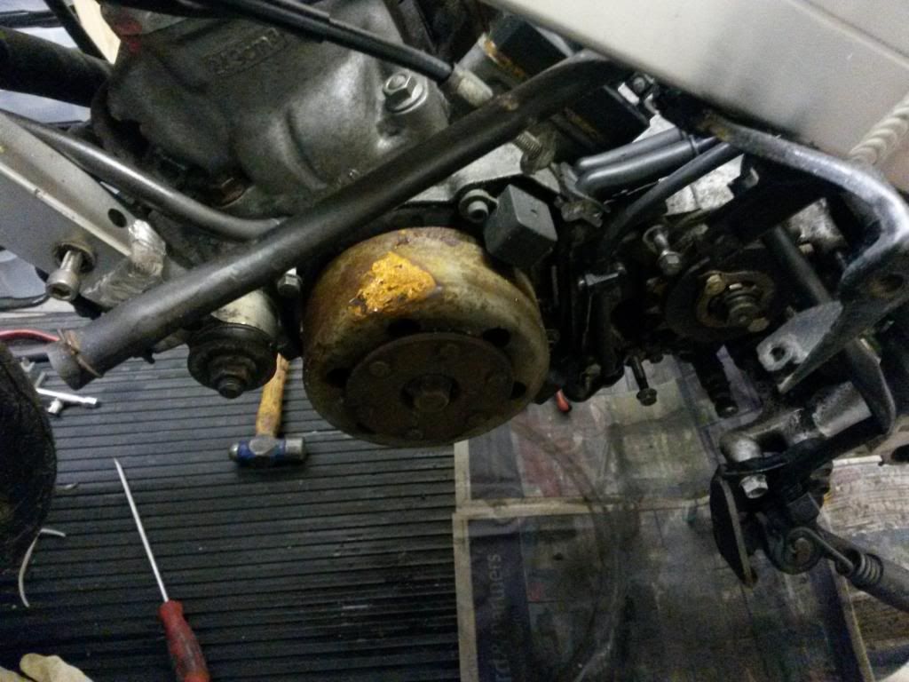

We all love pictures so heres some of what 13 years laid up does to a honda
Pretty grotty in there but its only surface crud really, the odd brittle and broken hose and the gearbox was full of 2 stroke oil so the oil seal has become dislodged. Had this on my old MC18 and is just a case of removing the oil pump and pushing the seal back in place with a little bit of sealant. Atleast its had proper coolant inside and not just water so it should still be nice and healthy inside.
