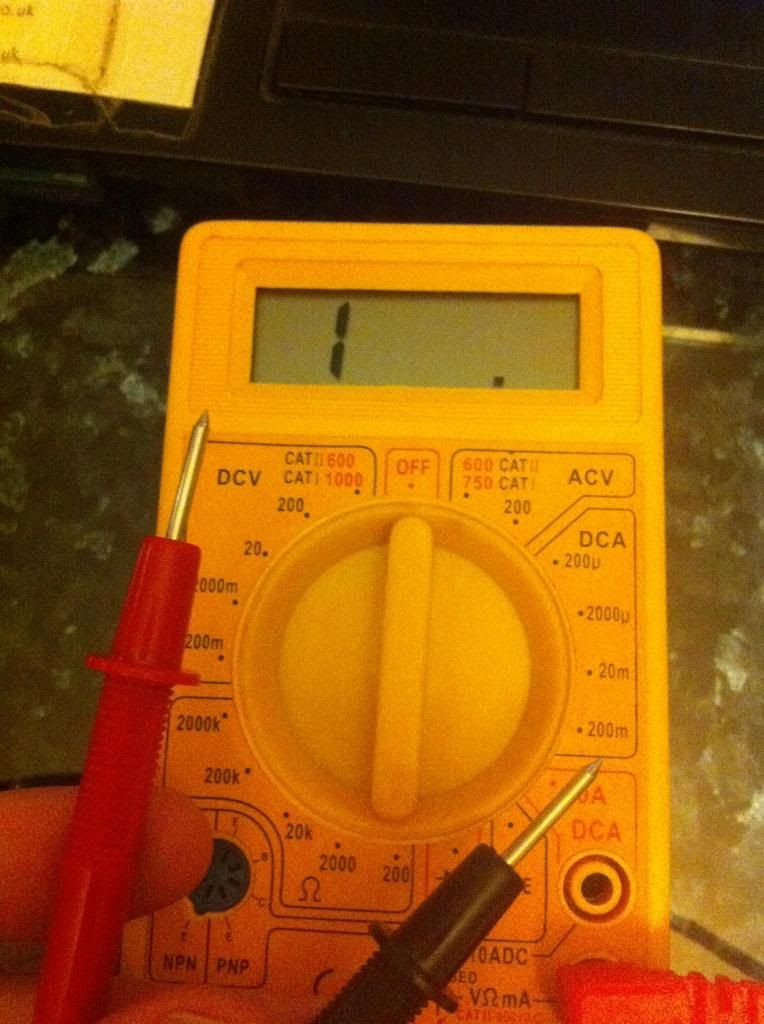

With the icu connected to the loom I get no reading regardless as to where I set the ohm scale on the multi, it just says one all the time right on the right hand side of the multimeter
2. Set meter to highest resistance range. Put +ve probe probe on the blue/yellow wire and the -ve probe on the black/white wire. Measure resistance.

A quick check of your multimeter, you do get zero resistance with +ve and -ve probes touching and infinite resistance when probes are not touching?

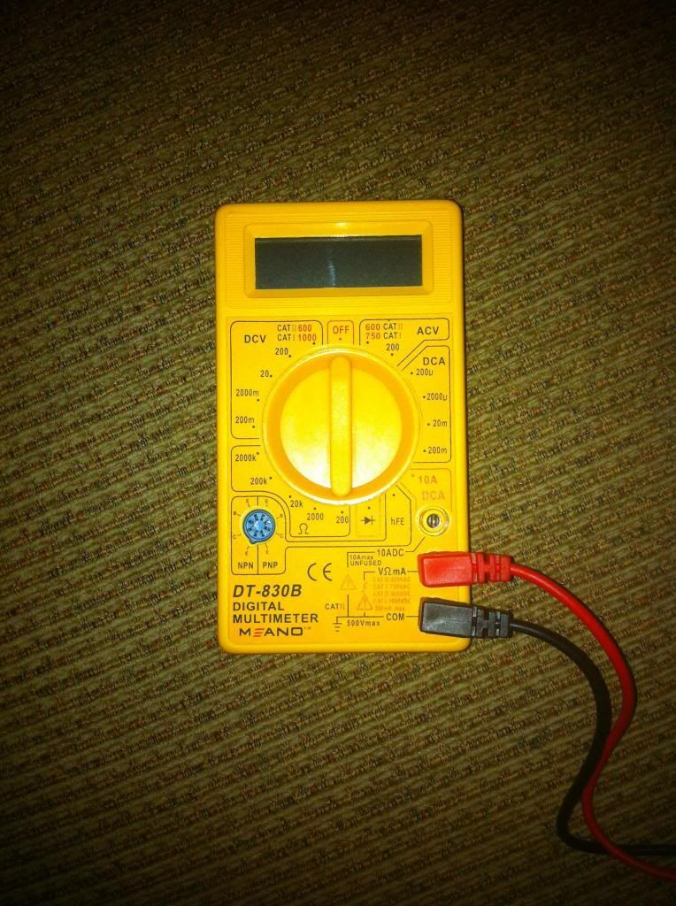

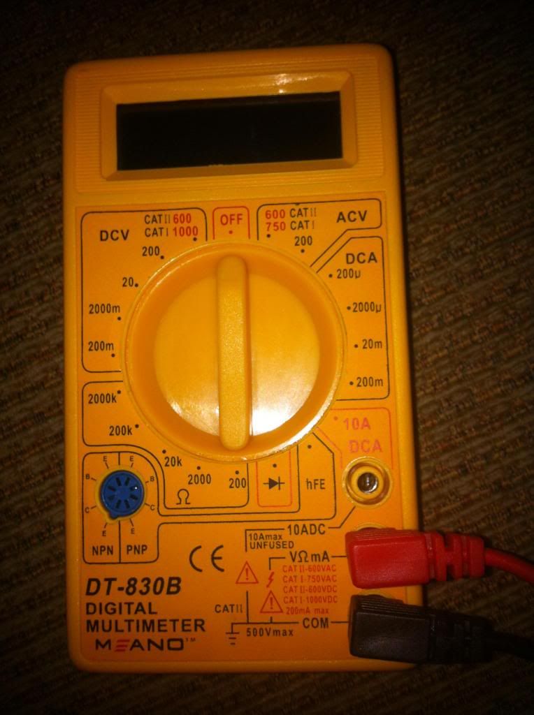

ok magg this is my multimeter, its basic and shit i know but it should do everything i need to wont it after all it did cost me £3.29!!!! man i am cheap.
so if i set it to the 200 Ohms so pointing at 6 oclock plug the cdi into the loom but have noting else plugged in then test the two spades that connect to the loom i should be getting a reading?

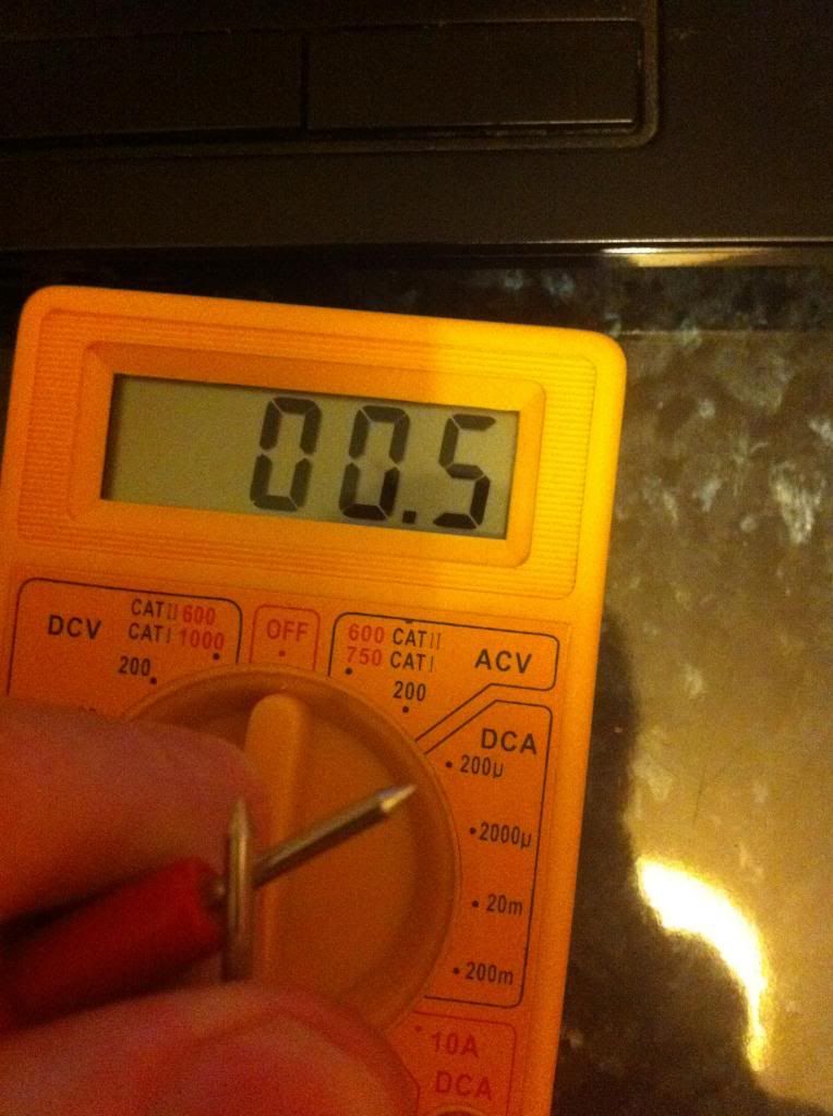

Currently im not, if i place the +ve on the black white wire to the front loom and the -ve to the black white wire on the rear coil i get a reading of 00.6.
so i have continunity of the live out of the icu. im guessing that by plugging in the icu i should have a complete circuit from black/white into the icu then back out to the blue yellow? but im not getting any readings, which is begining to get annoying.

Together on 200ohms
Apart on 200ohms
this is the reading i get wehn on the black white and blue yellow spades of the same coil with a good icu plugged into the loom but noting else plugged in, do i need the rhd run off switch gear attached?
