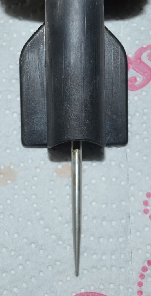

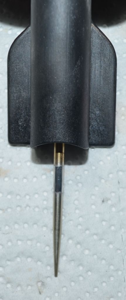

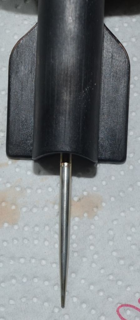

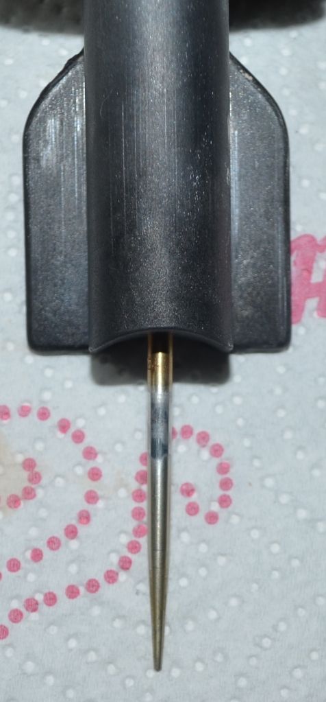

This weekend i decide to take out my carbs, and inspect them deeply as i can...
I realized that 1 & 3 needle have much more wear than others:
I little time ago i bought 2 3en carb sets for spares, so i take the best 2 needles of them and install them, they were close perfect than the good ones on the carbs....
Then i saw that 1 & 3 springs was 3-4mm longer than others, so replace them with 4 equal springs... A diafram plastic cover #4 has a crack on it, so i replaced with a perfect one.

It has been while, to make long history short, i bought a donor 3tj, so i decide to install the engine, carbs, wiring loom, tci from the donor bike that was all 3tj.
Now, she runs good, but still runing rich, because the 3tj carbs has pitted and worn needles..
