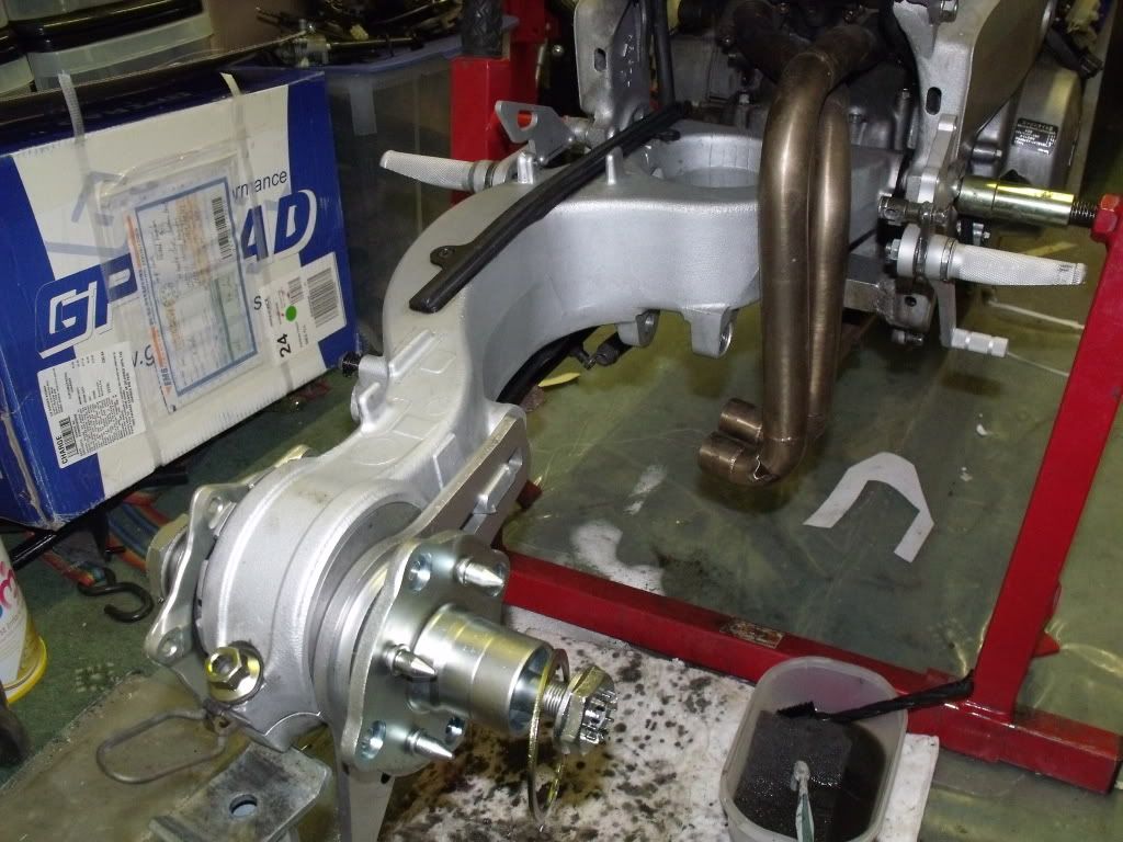

Pulled the rear hub apart, someone previously had snapped something off in the staked gap on the hub nut side of the axle
it eventually came off after a few attempts with the windy gun but wrecked the thread on the axle.

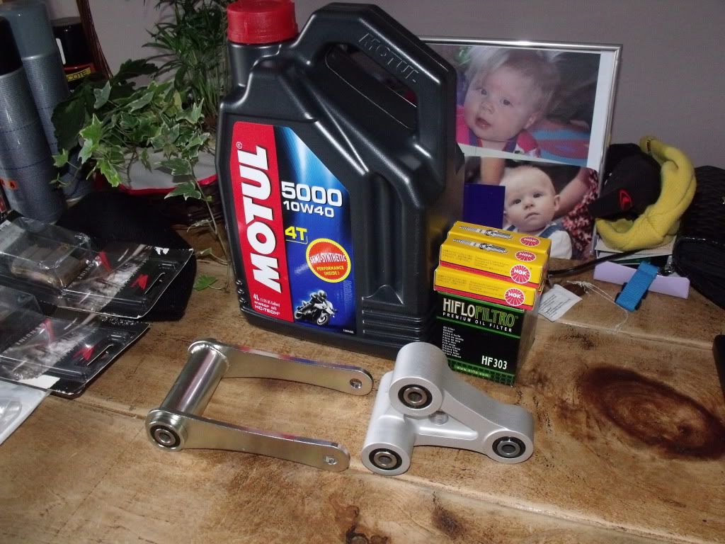

The maxton shock and linkage has now been removed in preparation for a upgrade, HRC replica linkage is on its way from rick which should work with the ohlins shock i bought a while back which although fits the NC right still has a spring way too soft usually used on a NC but should be perfect with the HRC linkage. Im also going to try one of the BMW S1000RR shocks as these although a tad too long have the right valving and spring rate for the linkage.
Usual crap inc 12mm socket found in swingarm
And heres one i prepared earlier,
Always nice to have fresh refurbed parts ready to fit

Some NC bling arrived today
