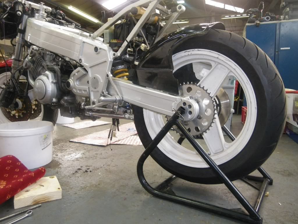

I've actually enjoyed doing the strip down and now the rebuilding, with a good clean, is quite satisfying. Luckily I've got a bike I can ride and a car when needed while doing this rebuild so I'm in no rush. Rather then just getting it together I can spend some time doing it properly (hopefully). I like to try and keep things clean and in good working order. Unfortunately 90% of the stuff I'm doing won't be seen, but I'll know it's done.
Shows how anal I am, do you know what bugs me most about this photo?
It's not the fact it's dirty, but that the fins on the oil filter housing don't go straight up
) Then one final clean and a quick rub down. I'll probably give it a bit of a polish before I'm finished. Also add a bit more grease to the bearings. I'm very happy with the way it's cleaned up, for a 25 year old bike (even though it's fairly low miles.)

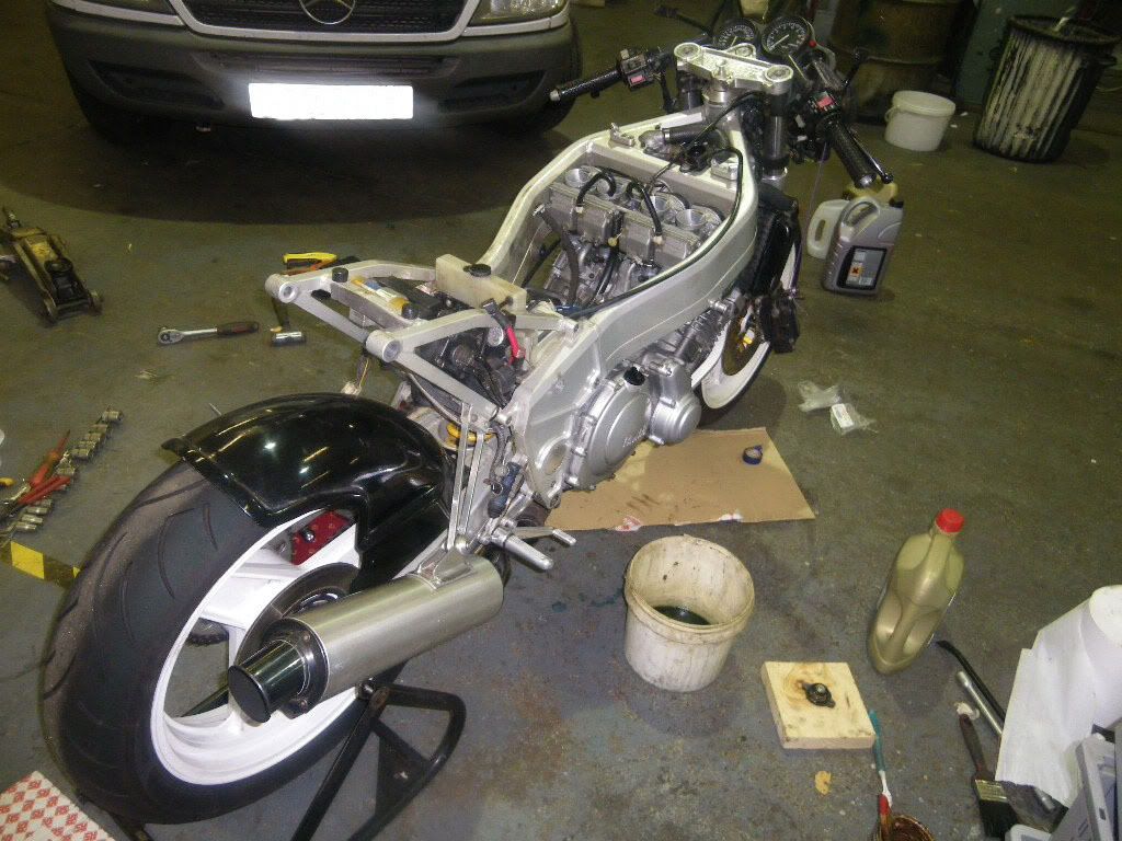

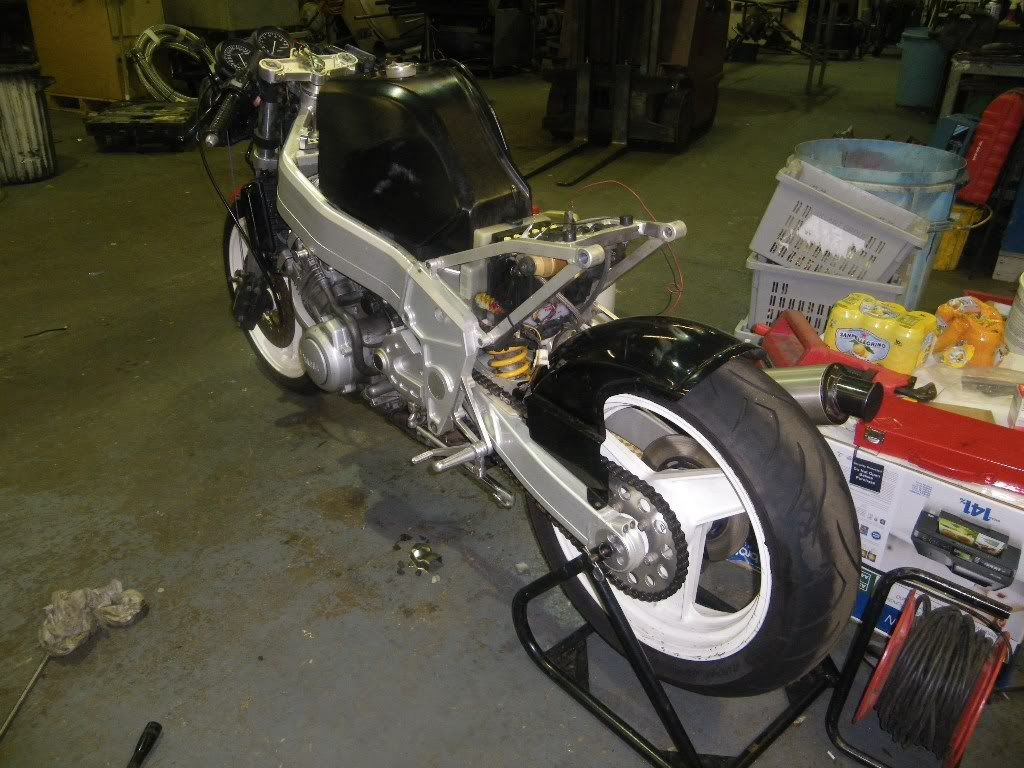

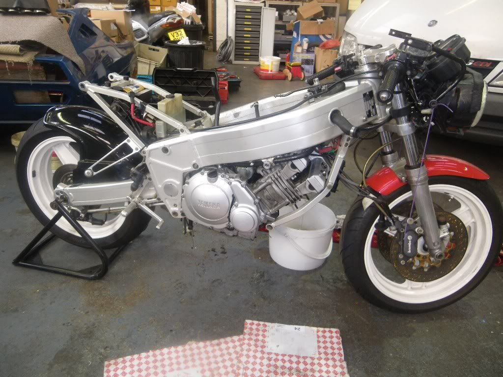

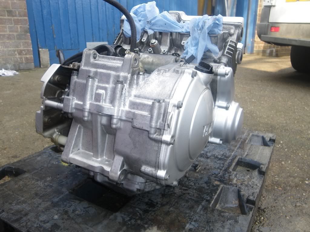

I finally got some time to continue with the YB7.

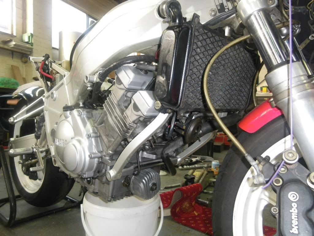

With the help of a friend I lifted the engine onto a trolley and took it outside for a clean,
I also gave the inlet tubes a bit of a clean too.
Lifted the engine back in and fastened the front braces. The barrels and head are not as clean as I'd like but I'll give it another go soon.
Cleaned up quite nice.
Radiator and hoses back on. I'll get it off again some time for a refurb and paint.

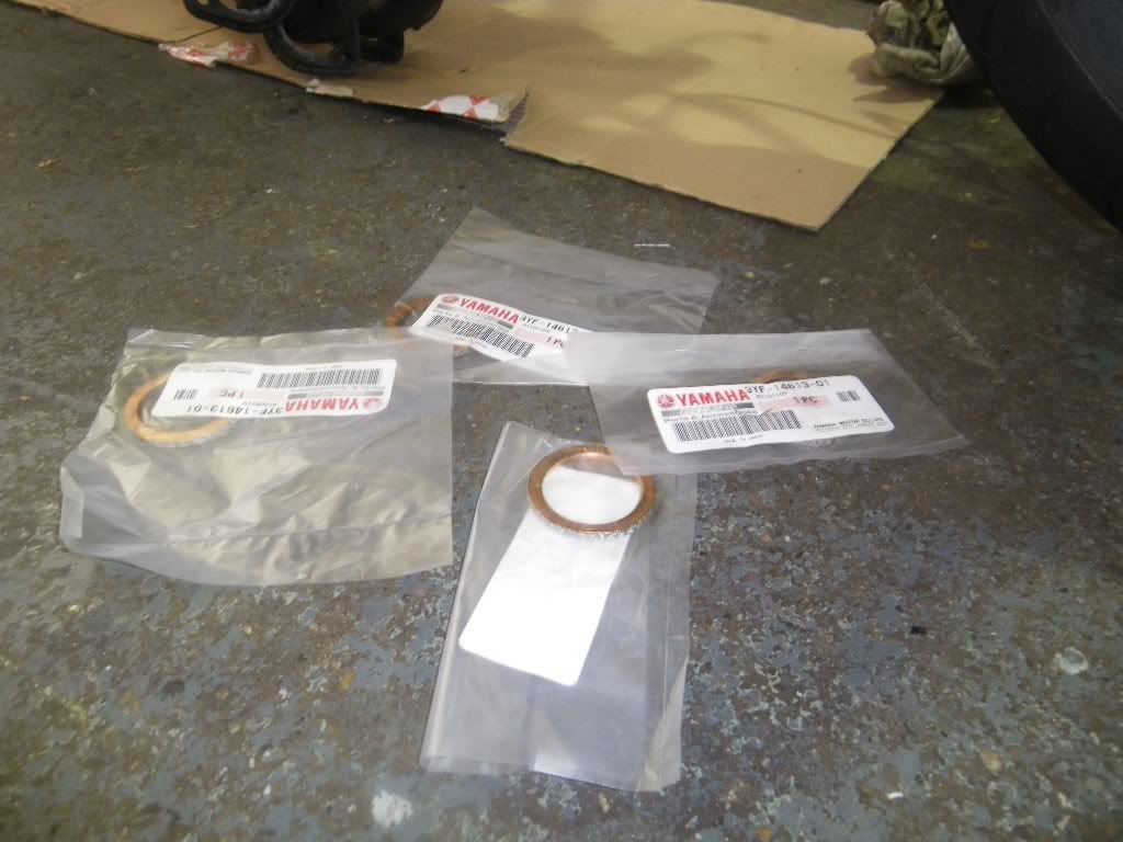

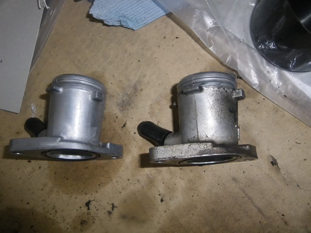

More new original gaskets,
Fluids going in. Some new anti freeze and oil. Exhaust also back on.
Fuel tank connected. Then it was time to push the button......
The battery was flatter then a squirrel after an incident with an 18 wheeler. It did turn over but very slowly, at least it'll of got some oil around the engine. I took my optimiser down and left it charging.
