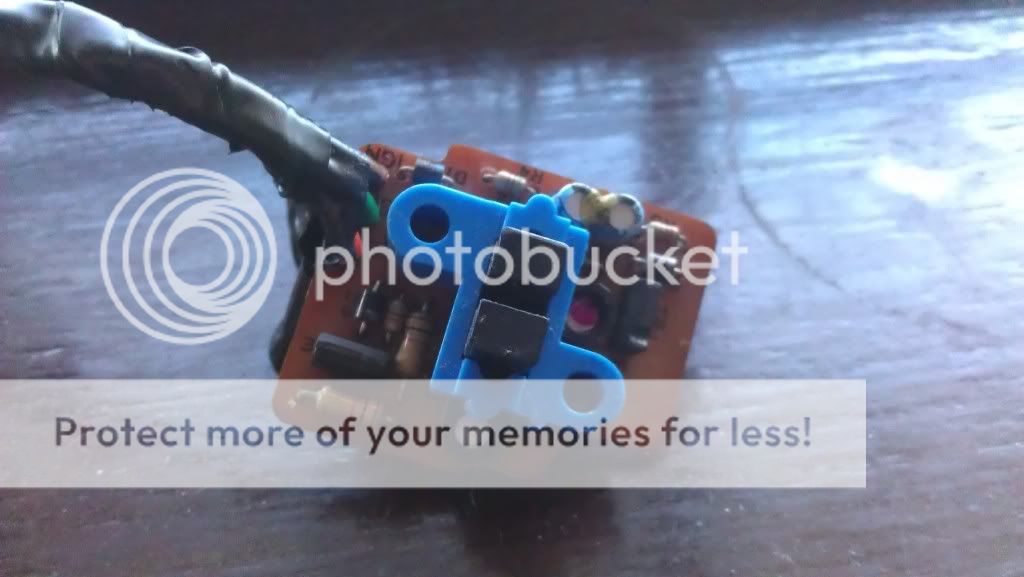

when me and my grandad were wiring up the Koso CLocks, we discarded this wire and unit, that plugge din somewhere at the front of my bike, ill upload some picture of it, could you tell me what it is ? and is this my old resistor ?
thanks Adam,

thats the speedo unit, it needs to be connected or you need to use the resistor.
goto your nearest maplins... if there isnt one you can order online. a 2k appox.. 2.2k is good metal film resistor.. doesnt need to be a high wattage.. there about 4p

so if I reconnect this it should rev fine? and would I still need the 2k resistor mod? thanks for your help Adam

As Neosophist said, PLUG THE SENSOR BACK IN OR GET A RESISTOR.

hi so does this do the same job as the resistor ?magg wrote:As Neosophist said, PLUG THE SENSOR BACK IN OR GET A RESISTOR.
what would be best to do ?
can the resistor Mod harm your bike ?
thanks for yours help, Adam

The resistor mod should help in getting rid of your flat spot and shouldn't harm your bike at all.
Re: HELP!!! Urgent, (KOSO) dash clock
Use either not both.
When the speedo board is connected it places an electrical load on the circuit, so the ignition box can sense that it is connected, this is the only check the ignition box does.
There are 3 wires, one of them is the 'trigger' when the trigger is activated by the speedo board (which won't happen if you just connect the board without the clock) then the ignition box cuts the revs at 180km/h.
The resistor you can use instead of the board just places a similar electrical load on the ignition box to what the original speedo board did, fooling the ignition box into beliveing the board is still connected.
