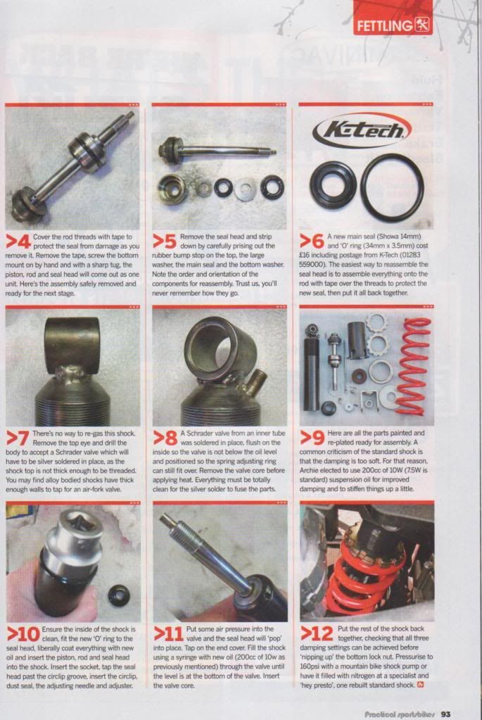

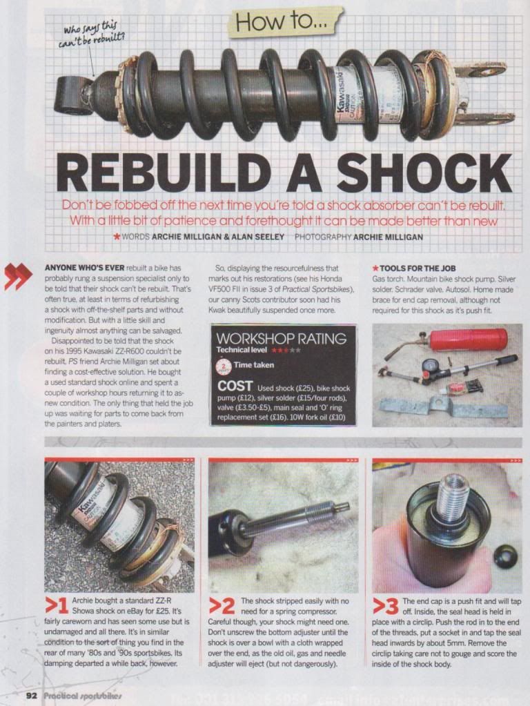

I suppose this is an infringment of copyright and if so I wil remove the link, it is however a good advertisement for Practical Sportsbike which is a great magazine
